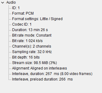

Attached is a tree from the new copy. I couldn't find the four LSBs you mentioned. -
You would look at LSBs (least significant bits, aka bits 12-15 of a 16bit sample) by exporting (demuxing) your audio to a 16bit Pcm WAV file, and looking at the bits in a hex editor to see if there are repeating patterns of Zeros. Or open in an audio editor and compare granularity (when zoomed all the way in) against a true 16bit file. Or better, if you have Audition you can look in the (Wav) file info stats to see the true bitdepth.
There is quite a difference in quality between 16bit48k and 12bit32k, so it might actually be worth your while to test multiple clips with different systems to see what you truly have or ought to have.
Do you have tapes where you have examples in both the old & new capture? play them back-to-back and you should be able to tell which setup got it right and which got it wrong (for that clip at least).

Since MediaInfo shows Sampling rate of 32k, that means the Bit depth is 12? (it shows 16 here) -
digital sampling at 32k limits the high frequency to a top end of 16khtz vs 24 khtz at 48k. 12 bit only has @ 4k discrete sample steps vs 16 bits 65k samples.
it's possible to have 32k16bit, just not found often.--
