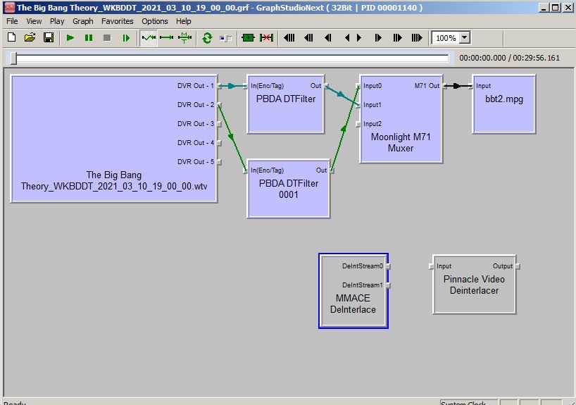

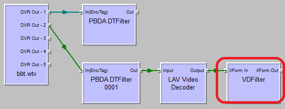

    Without getting into the pros & cons of deinterlacing, does anyone know how to insert a deinterlace filter into the workflow that I'm using?
    I'm coverting .wtv files to mpg and was wondering if a deinterlacer would work in the Graph, inasmuch as the two DirectShow filters (shown in the image) either refuse to co-operate or crash the program - and where would it connect in the graph.
    Looking for something similar to the Yadif filter used in VirtualDub2.

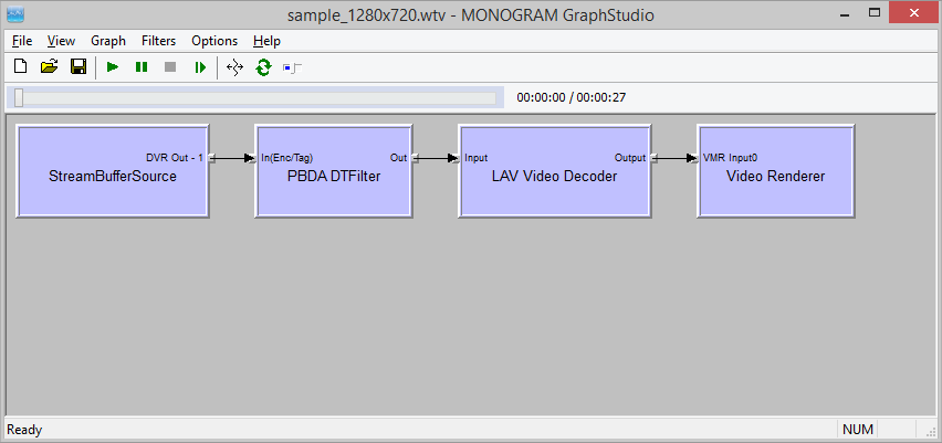

    Perhaps you can get LAV filters into the graph and use their de-interlacing options

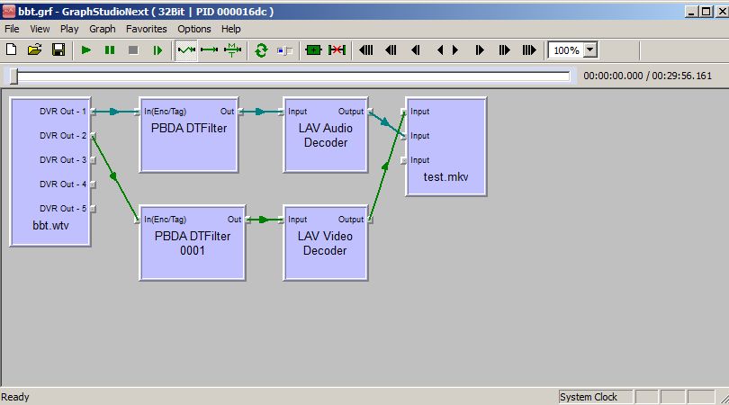

    Thank you for that hint - and yes it does what I want but the only way I can get output is to use the HAALI Matroska filter hard wired to the decoders and the resultant files are huge.
    The DirectShow codecs that I try,error-out when I initially insert them or crap out when I start the graph.

    What is that filter on the right? I can only assume LAV is providing uncompressed video to that filter
    (there is no re-encoding step)
    Can you provide a sample interlaced wtv file? If so just upload it here

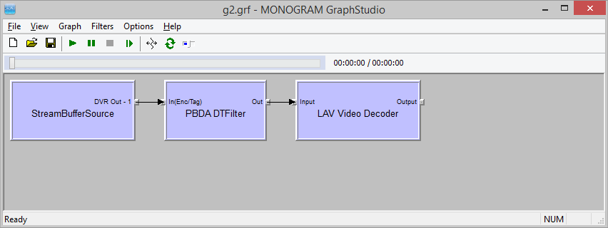

    Perhaps there's another way. Create a graph but leave the last pin missing,
    file/save as graph (eg. save the .grf on the desktop)
    Create a simple one line Avisynth script to open it with directshowsource like this:
    directshowsource("C:\Users\davex\Desktop\g2.grf",audio=no)
    Open the script in Virtualdub2 and re-encode (after first setting the deinterlace filter etc.)

    There is also an utility named VDfilter from infognition that can eventually be used and does allow to use vdub filters and in vdub you have several deinterlace alternatives.
    "VDFilter is a DirectShow transform filter which allows to use VirtualDub filters in DirectShow applications such as GraphEdit, GraphEditPlus or your own".
    http://www.infognition.com/VDFilter/
    Never used it so cannot confirm it works as described but it will be easier to make a test and see for yourself

    Thank you both for your kind assistance.
    @FLP437

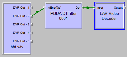

    The VDub filter works - but it insists on hooking in the Lav Video Decoder (which has the deinterlacer included) so opening the graph in VDub to deinterlace again would be redundant, and it is deperately slow (3.5 fps).
    @davenext
    As per your suggestion I created an AVS script to open the graph in VDub.
    Note that the Lav Video Decoder is automatically inserted which creates the same situation as above - although processing is speeded up to real time.
    My aim is still to have the deinterlacing completed and the wtv file output as .mpg using the Moonlight Muxer filter (or similar).
    I'm not proficient enough using the graphing programme to figure how.
    Cheers!

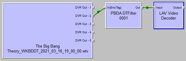

    I gave up on the VD Filter because of problems invoking it.

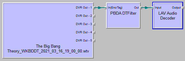

    Instead I opted to make two separate graphs (one for audio and one for video)
    The video graph using the LAV video Decoder was set to deinterlace the source.wtv file.
    An .avs file calling both graphs was opened in VirtualDub to resize and export.
    V=DirectShowSource("C:\Users\Superuser\Desktop\Wor king Graph\pin open.grf", audio=False) # video only (audio renderer removed)
    A=DirectShowSource("C:\Users\Superuser\Desktop\Wor king Graph\pin opena.grf", video=False) # audio only (video renderer removed)
    AudioDub(V, A)
