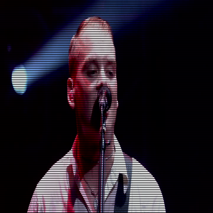

    Hey! I have a video file I'd like to restore, which has weird horizontal lines all over it. I think it might be a bad deinterlacing job, but to be honest I'm unsure what it is exactly. This is how the source looks. How would I go about fixing something like this? (I know the aspect ratio is not correct). Sample attached. Thanks!
    Dec 2005
    Finland

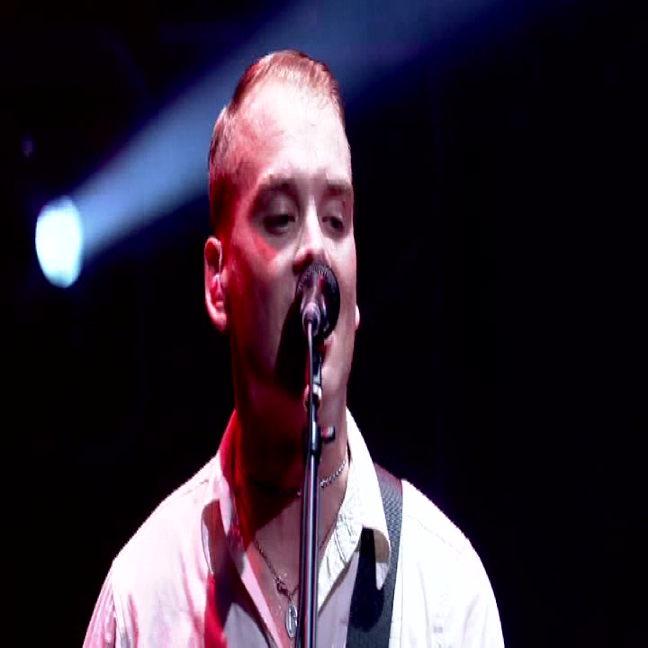

    It looks like the image has been poorly resized in the vertical direction. Rather than interpolating smoothly from 720p to 480p, I believe two lines have simply been discarded every four lines. To try to undo this, you need to replace those missing rows somehow and then resize the video correctly.
    Original, stripey image:
    Empty space inserted every four pixels, stair stepping is largely gone:
    Missing lines filled in:
    And resized back to the original height:

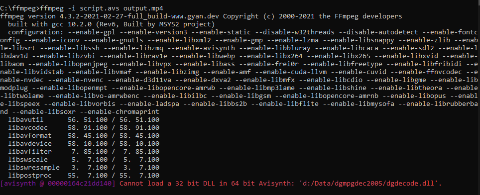

    I'm getting this error, even though I installed the only version of Avisynth I can see, which should be 32 bit. What do I need to change?
    [Attachment 57770 - Click to enlarge]
    Dec 2005
    Finland
    Hmm... well the message certainly seems to indicate that a 64 bit AviSynth is being used - is it possible you have multiple copies installed, perhaps some other package you have installed included AviSynth with it?

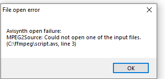

    Okay, so I reinstalled Avisynth+, and deleted it with its own uninstaller this time. Now it gives this error:Image
    [Attachment 57772 - Click to enlarge]
    Script looks like this:
    # DGDecode:
    LoadPlugin("d:\Data\dgmpgdec2005\dgdecode.dll")
    MPEG2Source("d:\Data\MattyP\vegas\full.d2v")

  9. Open your scripts with VirtualDub2. It should give you a better error message.
    One of the main things to watch out for is "bitness". If you use a 32 bit editor/encoder you must have 32 bit AviSynth installed and 32 bit versions of all the 3rd party filters. If you use a 64 bit editor/encoder you need to have 64 bit AviSynth installed and 64 bit versions of all the 3rd party filters.
    Note that SeparateRows() and WeaveRows() are not included in AviSynth, only AviSynth+.
    Dec 2005
    Finland
    Looks alright to me - does it work if you leave out everything after MPEG2Source()? If yes, it could be the SeparateRows() call, it was added in AviSynth 2.60 so an older version would fail there.
    You could also try loading the script in VirtualDub, perhaps it can present a more meaningful error message.

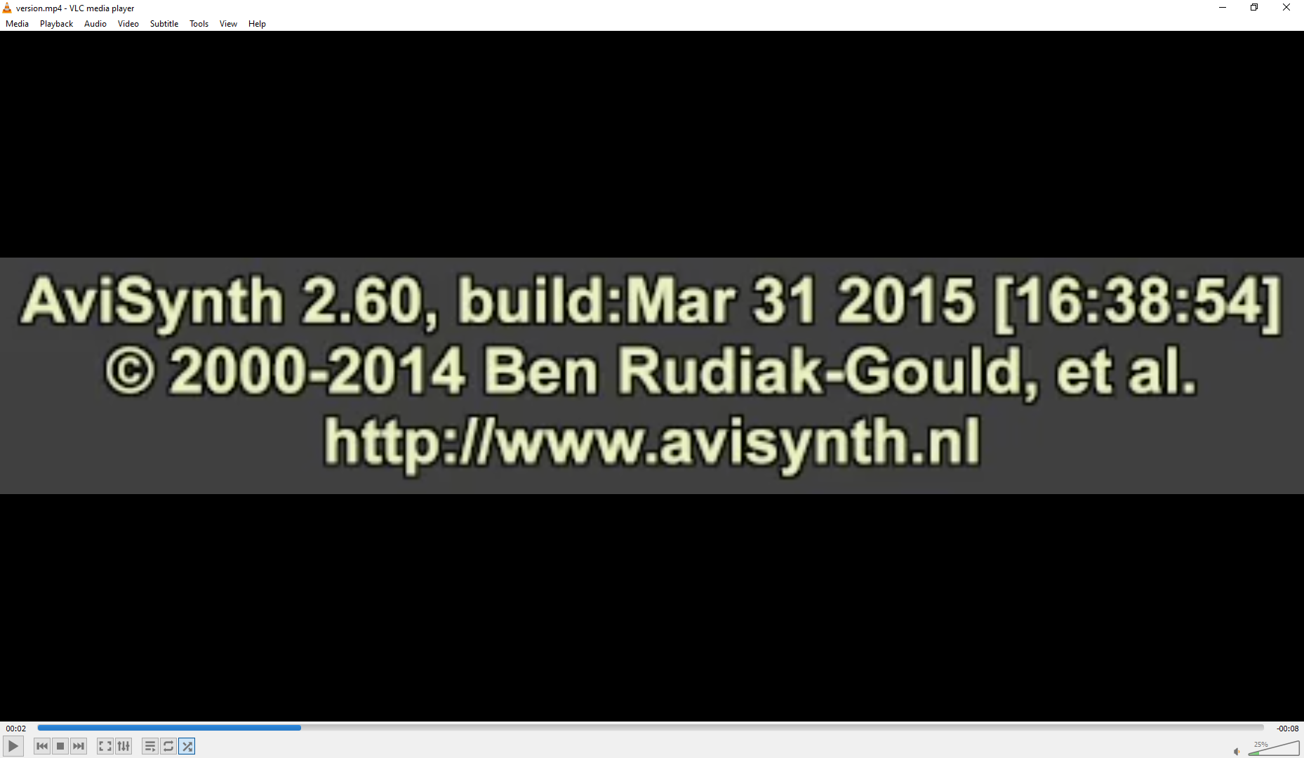

    Make a simple script with just "version()". Open it in VirtualDub and encode it with ffmpeg. Compare the results.

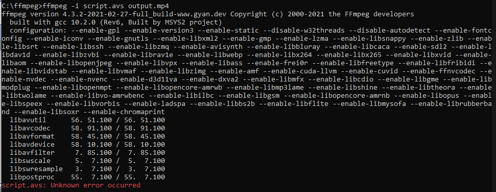

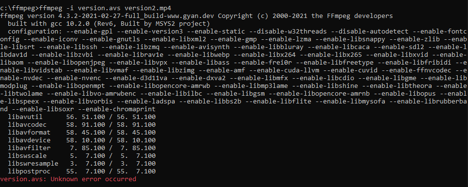

    No, sorry, I misunderstood you. ffmpeg throws a generic error:
    [Attachment 57775 - Click to enlarge]
  19. Then you are probably using 32 bit VirtualDub with 32 bit AviSynth, and 64 bit ffmpeg but don't have 64 bit AviSynth installed. Or are trying to load a 32 bit filter into 64 bit AviSynth:
    That lines needs to point to a 64 bit version of dgdecode.dll. Or just get a 32 bit version of ffmpeg.
