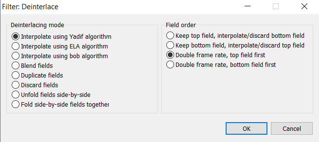

As part of my current project, I ingested a number of VHS/VHS-C tapes on my laptop with VirtualDub using a lossless encoder and a USB capture device. Since I will need to resize the content in the future, I need to deinterlace the files. I used the deinterlace filter in VirtualDub with the options below
[Attachment 57744 - Click to enlarge]
The results were disappointing. There is a striking difference between the colors (?) of the consecutive fields. As a result, the video is not smooth and "shakes" or "jitters" a little. I triple checked that the video is Top Field First before applying the correct filter option.

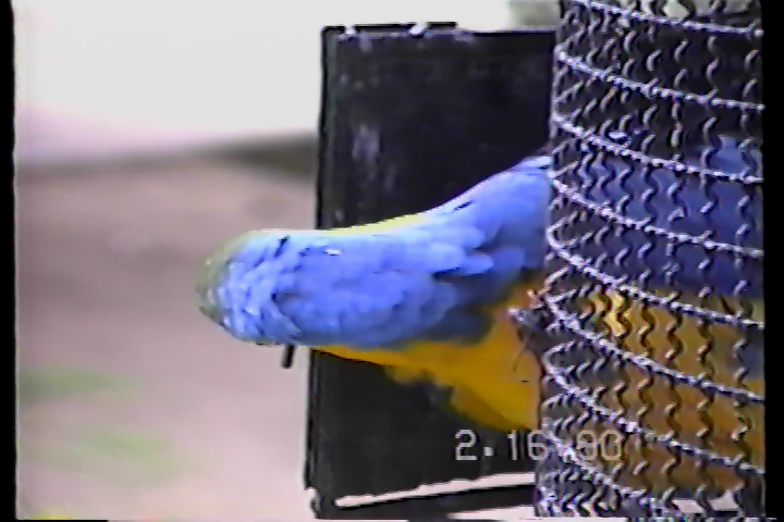

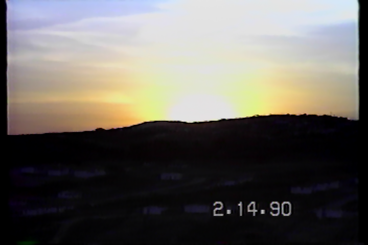

See some examples of consecutive fields below. Look at the sky colors on the first pair and the ground on the background on the second.
Test1 - Field 1
[Attachment 57745 - Click to enlarge]

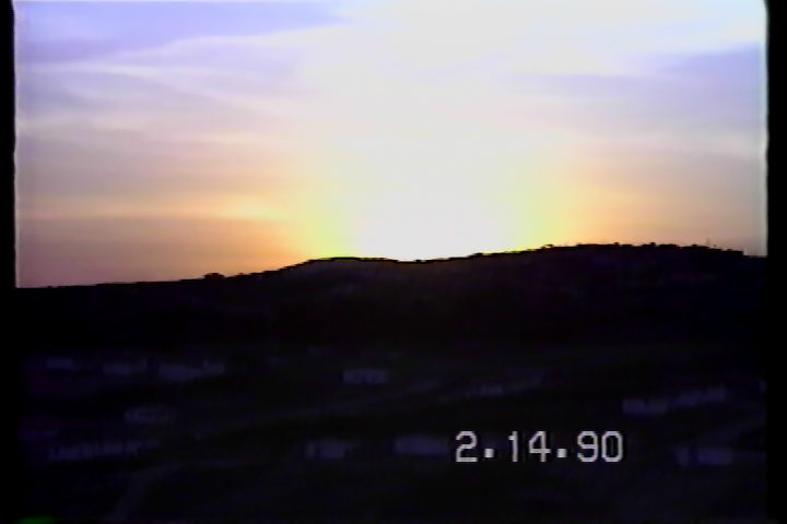

Test1 - Field 2
[Attachment 57746 - Click to enlarge]
Test2 - Field 1
[Attachment 57747 - Click to enlarge]
Test2 - Field 2
[Attachment 57748 - Click to enlarge]
I uploaded two very short video snippets with the original video and the one after deinterlacing. If you open the deinterlaced video in VirtualDub and step through it you will see the issue. Let me know if you need more samples. I also included below the MediaInfo output for the file from which I extracted the short video attached and pictures in this post.

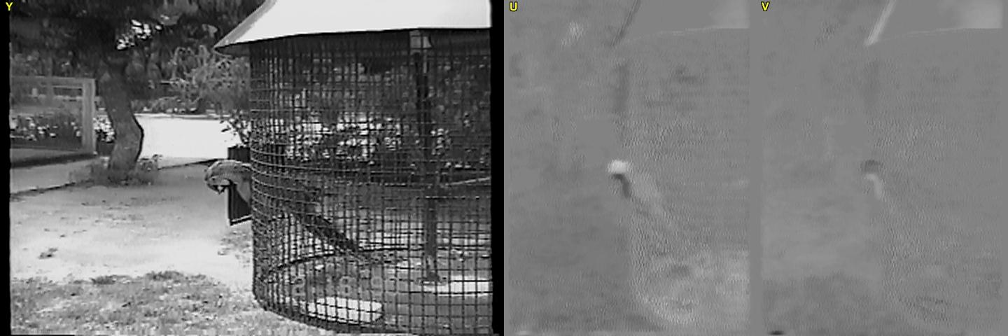

There is something wrong with the U channel of your captures. It flickers brighter/darker from field to field.
top field:Code:LWLibavVideoSource("Test 2 - original.avi") AssumeTFF() ConvertToYUY2(interlaced=true) Bob(0.0, 1.0) StackHorizontal(GreyScale().Subtitle("Y"), UtoY().Subtitle("U"), VtoY().Subtitle("V"))
[Attachment 57763 - Click to enlarge]
bottom field:
[Attachment 57764 - Click to enlarge]
I believe this is a problem with your VCR.

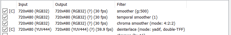

1. Is there a specific order in which to apply filters in general? For instance, lets suppose that I want to apply the following filters: chroma correction, noise reduction (smooth and temporal smooth), brightness, deinterlace, and resize. What is the right order?
2. (this is probably very stupid but I need to ask for my learning benefit) This is related to my previous question. I was playing with the filters in VirtualDub trying to approach the problem I brought up in this thread and noticed that if I apply the following filter sequence:
[Attachment 57786 - Click to enlarge]
The difference in color between fields in the resulting deinterlaced media goes away. I am probably missing something. Maybe I am loosing quality, etc.? I would appreciate if you could provide some insight.
Thank you
crbd98
