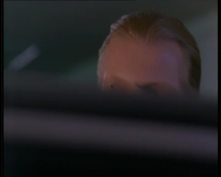

    I have a big stack of videos that have been deinterlaced with some kind of blending (not sure whether frame or field) and that method created some annoying ghosting. I don't have the original interlaced files, which is why I'd like to try and see what can be done in this case. The videos are ripped from DVD. Below is attached a part of one video.
    I'd prefer if the method of repair was in Hybrid, tool made by Selur. If that's not possible, other solutions will do too.
    Thanks in advance!

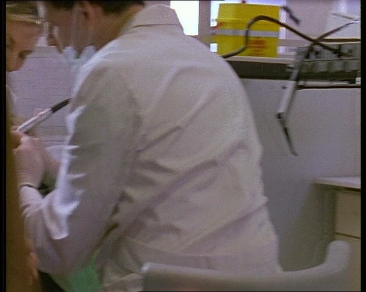

  3. Actually, there is some very light blending. It's most obvious in a shot near the end of the clip:
    [Attachment 57743 - Click to enlarge]
    You can see it to the left of the thin black instrument dangling down near the right of the frame. I don't see any easy way of eliminating it. I tried subtracting a small portion of then next frame but it didn't help much:
    next = loop(2,0,0)
    Overlay(last, next, mode="subtract", opacity=0.05).ColorYUV(gain_y=12, cont_u=12, cont_v=12)

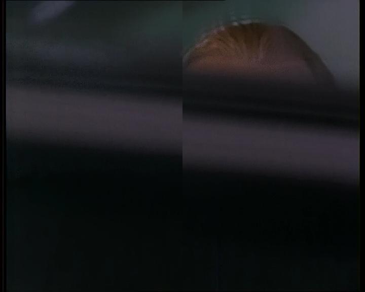

  10. I agree, the "ghosting" in the video is not from any kind of blend deinterlace or field blending from a frame rate conversion. Here's a split screen image of one frame on the left and the next frame on the right:
    [Attachment 57782 - Click to enlarge]
    The camera is panning up here so the blurred roof of the car in the foreground is moving down the frame. You can clearly see the light "ghost" on the right half lines up with the edge of the wide light band on the left. And there's at least two generations of ghosting. A few frames later when the camera stops panning there are no ghosts -- so this isn't some real detail of the car.
    [Attachment 57783 - Click to enlarge]
    This ghosting points at a temporal noise reduction filter with a threshold. One can get similar results with TTempSmooth() in AviSynth. Something along the lines of:
    TTempSmooth(maxr=2, strength=3, lthresh=20, cthresh=20, lmdiff=10, cmdiff=10)
    Off the top of my head I don't see any easy way to undo this. I might think about it some more later.
