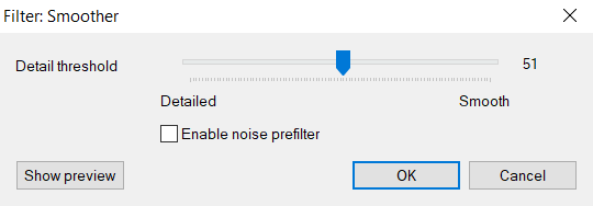

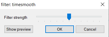

I was intrigued by your statement that you "apply noise reduction and chroma correction to the entire file." I tried that approach using the filters in VirtualDub. I noticed that applying noise reduction (the smoother and temporal smoother filters in VirtualDUb) would blur the detail in some scenes. For instance, it smoothed the ocean waves and dampened the reflections of a sunset in the water. Maybe I am using them incorrectly? Too much smoothing? Here are the settings I used:

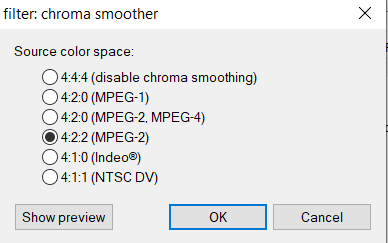

Regarding chroma correction, I am unsure which options to use. I simply selected the value that matched the one MediaInfo returned for the file. Here are my settings:
[Attachment 57753 - Click to enlarge]
