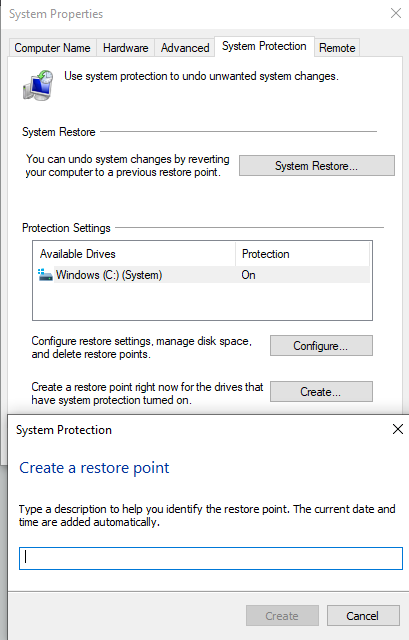

    Type "restore" in the Task Bar's Search field. Select "Create a Restore Point". From the dialog select "System Restore" on the "System Protection" tab. Follow the instructions from there. Pick a restore point from just before the update was installed.

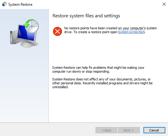

    hey, thanks for your reply back. here's what i got in the photos below. so it appears i have no restore points and i cannot create any either, is it because i have reset my pc numerous times in the past? (its not the best), and this error has happened to my NTSC recorders (in which i idiotically threw away since i thought they went bad) and the now used PAL recorder, (from the MPG i just uploaded for reference) it's a 2 head mono vcr, so that tells me it is indeed this software ArcSoft ShowBiz doing this and not any vcr recorders.... what else can i do??
    EDIT: yes this does happen when ripping tapes and it leaves all that jarbled mess in my broadcasts, its very disorienting to my eyes because i rip AC/DC videos, and the quality ranges differently, some are very old bootlegged black and white broadcasts & others are high quality and untouched almost laserdisc dvd like quality, but that jumping flickering crap stays on the screen, even if i dont hit the play button to start the tape
