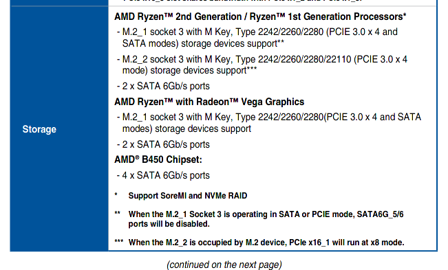

    Well according to the manual i have to confess that it can be complicated
    [Attachment 57686 - Click to enlarge]
    It looks like it depends on what processor you are using? if that is a ryzen first or second both m2 will work although m2_2 will NOT accept sata protocol.
    If using ryzen with radeon vega graphics it states only m2_1 and 2 sata ports but nothing about m2_2
    canada
    It says that if m.2_2 is used then the video card (if used) will run at 8x instead of 16x mode,nothing about the other sata connectors.
