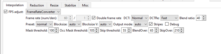

  1. I have been suing Hybrid to interpolate videos, however I have an issue when I try and use the "FrameRateConverter" option. It speeds the video up. I don't know why it is doing this, is there a setting you have to change in order to stop it doing this? I have attached a picture of the setting it defaults to.

  2. I have an issue when I try and use the "FrameRateConverter" option. It speeds the video up.
    sounds like a bug in which the frame rate isn't adjusted properly,... would need a debug output to know for sure.
