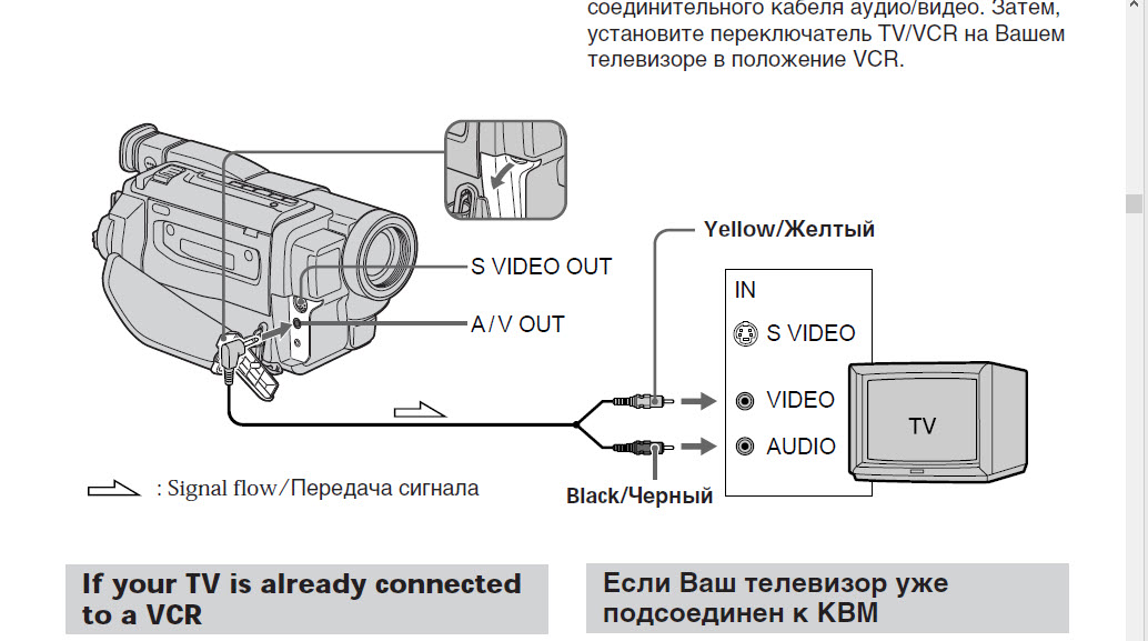

    You do realise that you can not immediately buy this. It is an auction and there are already 2 bids in. There may even be 'Shell Bidding' to bump up the final price.
    I did not see any mention of an a/v cable which would have been originally supplied and essential for viewing/transfer.
    this is also from Sony information
    https://www.sony.co.uk/electronics/support/camcorders-tape-camcorders/ccd-tr728e/manuals
    from page 34 you can get al details
    [Attachment 57651 - Click to enlarge]

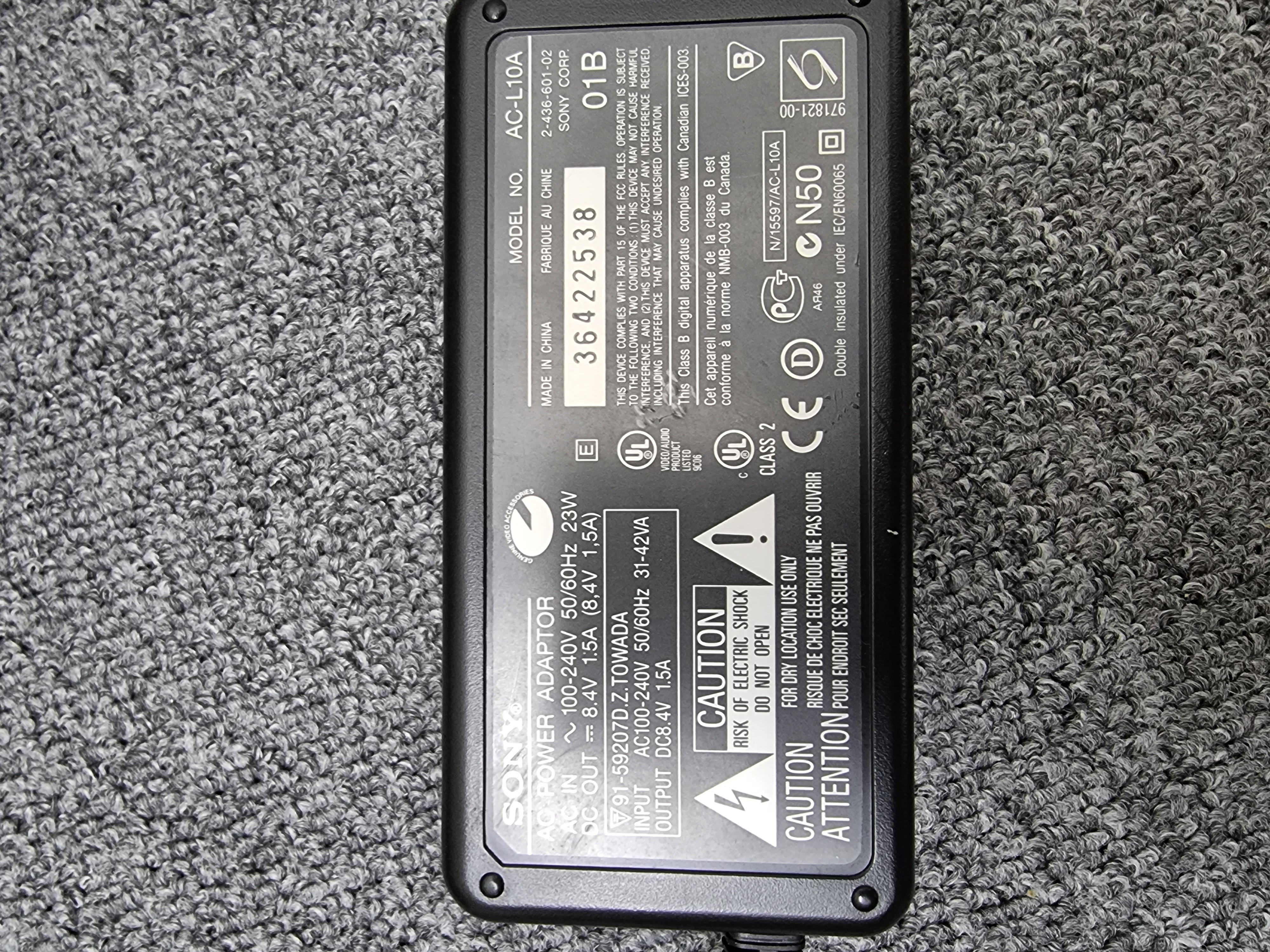

    This still makes me curious. The NTSC camcorder would, I assume, have come with a power adapter for 110 volts to whatever the camera required. How did you fit that adapter for your own country's 220/240 volts.
    Some weeks ago, I contributed to a thread where a US member had acquired a UK device. He did not understand why it did not fully work. Only when he could feed 220/240 volts to it did it work.
  9. Originally Posted by DB83 View Post
    the camcorder i was purchased it was compatible
    [Attachment 57653 - Click to enlarge]
    it was happened for me before , i was purchased from amazon , so the device has been burst this is the device
    https://www.amazon.com/gp/product/B001TOD3KU/ref=ppx_yo_dt_b_asin_title_o08_s00?ie=UTF8&psc=1
    so i purchased Convert electricity from Bahrain , if the power its 110 so it will give me 220/ 240
  10. Capturing Memories dellsam34's Avatar
    Jan 2016
    Camcorders and laptops have universal voltage compatibility, All what's needed is the socket adapter.

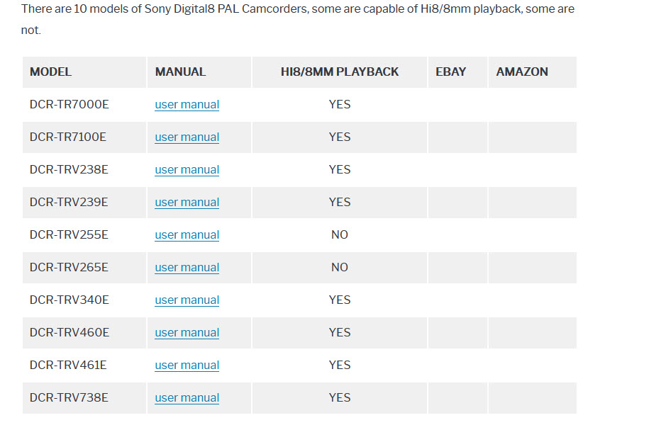

    The PAL Digital8 camcorders you will be looking for is as follows:
    DCR-TR7000E User Manual
    DCR-TR7100E User Manual
    DCR-TRV238E User Manual
    DCR-TRV239E User Manual
    DCR-TRV340E User Manual
    DCR-TRV460E User Manual
    DCR-TRV461E User Manual
    DCR-TRV738E User Manual
  20. Capturing Memories dellsam34's Avatar
    Jan 2016
    Lets take DCR-TRV460E and DCR-TRV461E off the list since they are not equipped with S-Video out.
