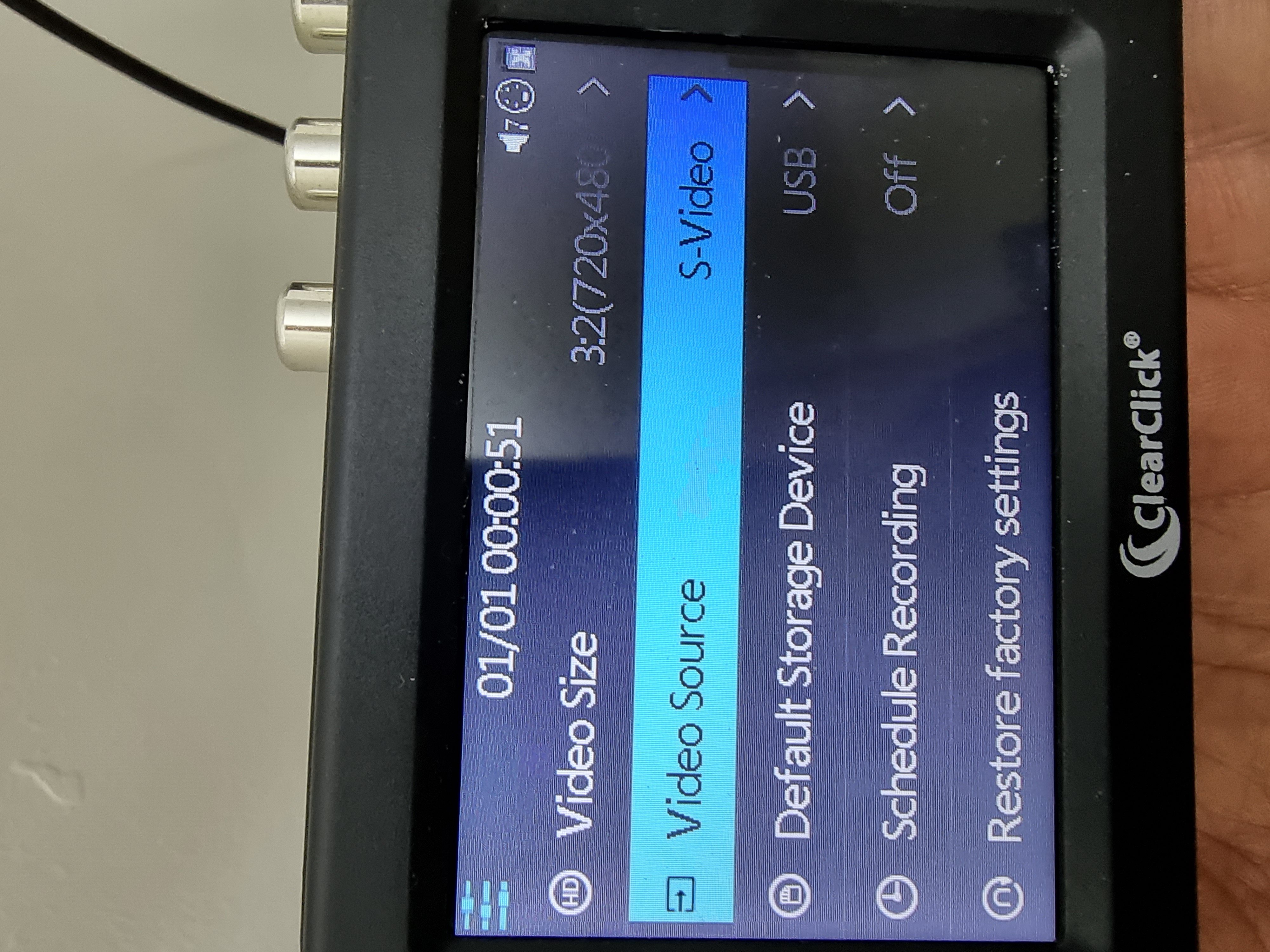

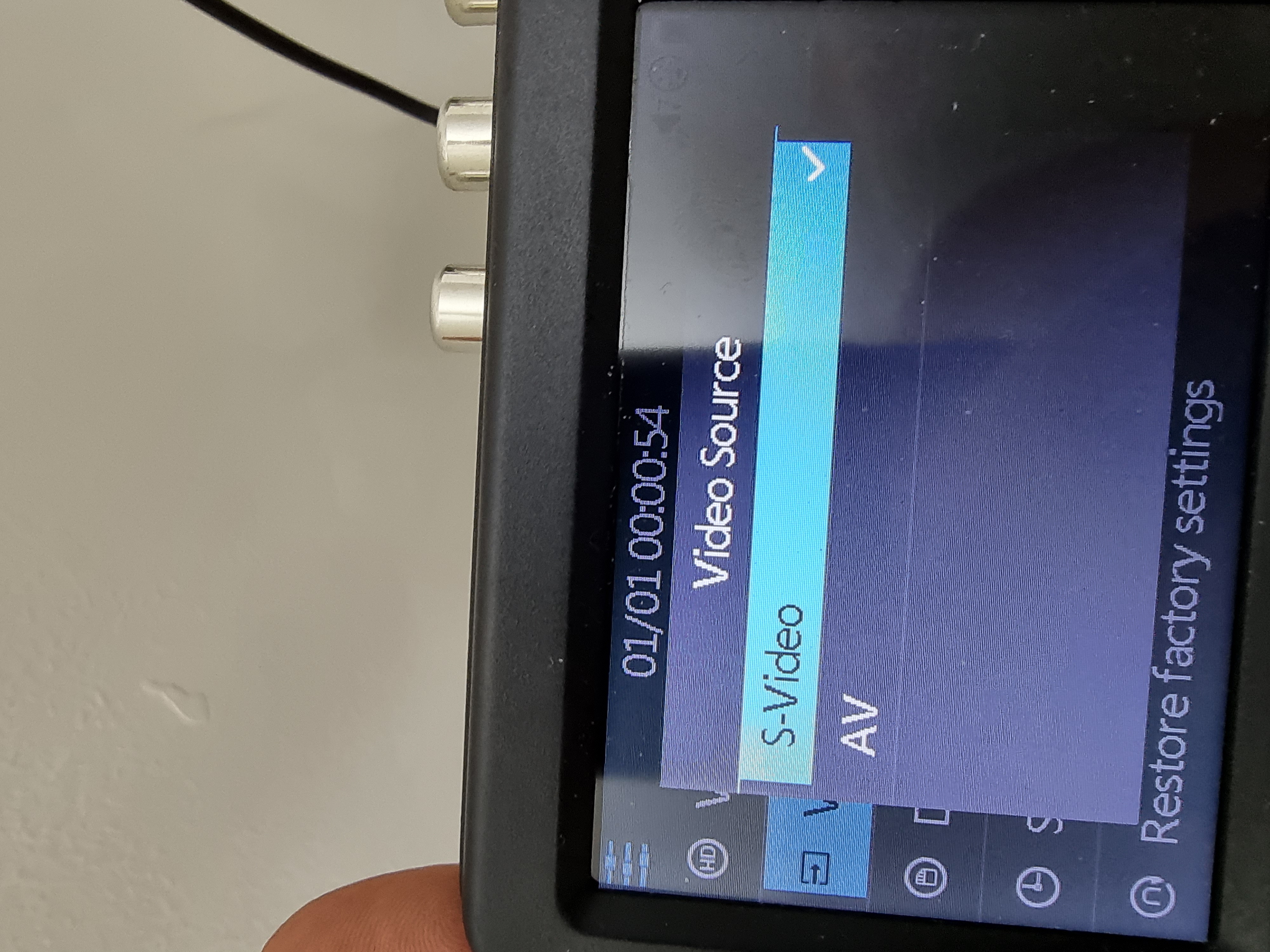

    there no setting can do that , its only if you want to keep S-video or AV

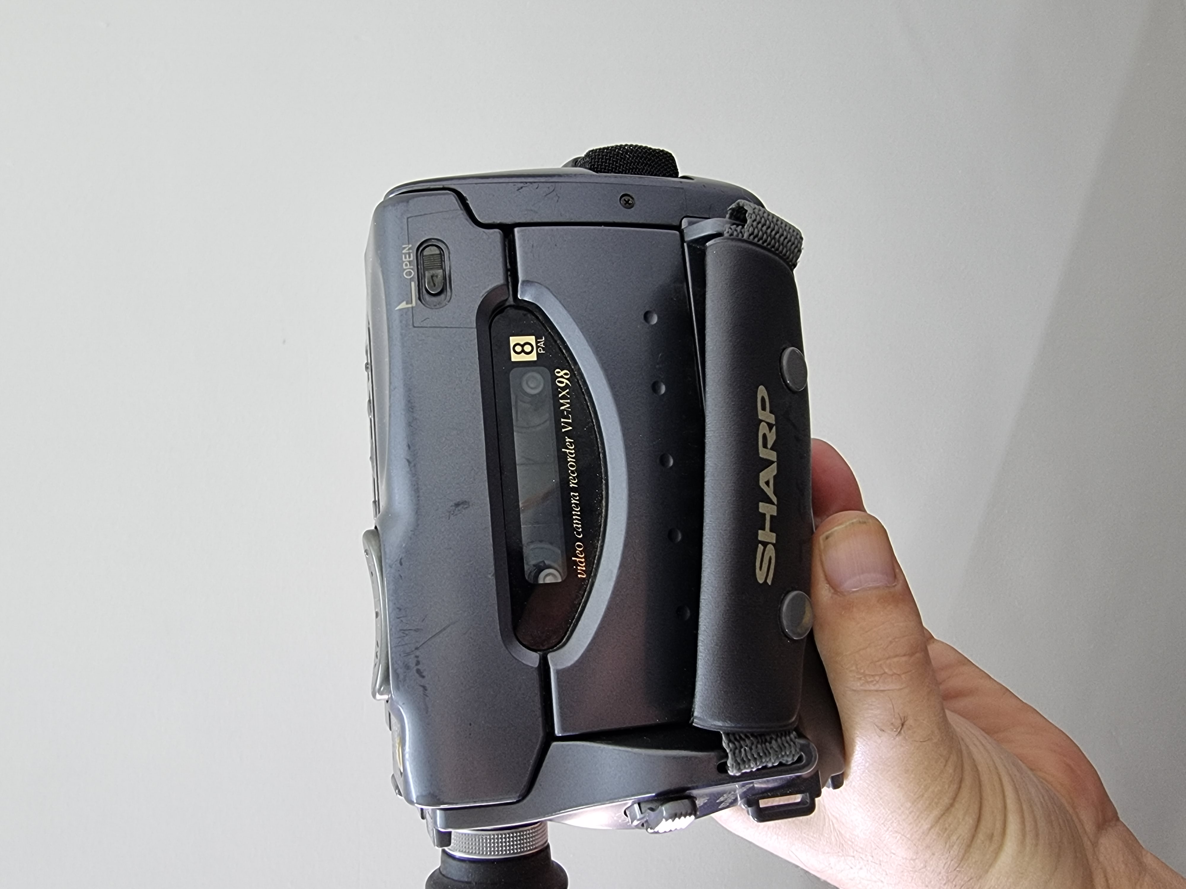

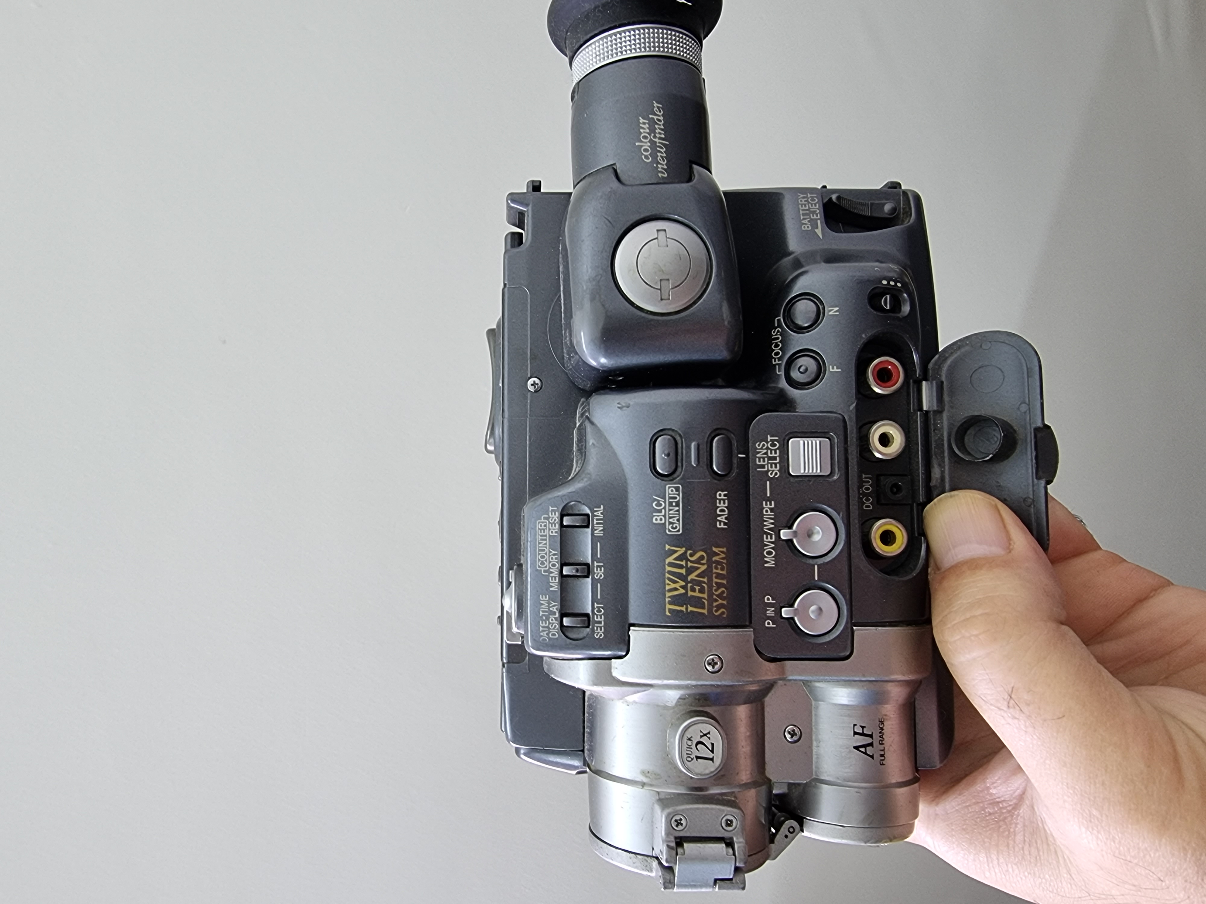

    the old Camcorder that i was recording on 1993 was 8 PAL , here are the link of Camcorder
    //imged.com/sharp-vl-mx98e-gy-vl-mx98e-twin-lens-system-camcorder-video-camera-japan-54541865.html
    [Attachment 57636 - Click to enlarge]
    in fact i was not keep in my mind if its PAL or NTSC , i was not have experience in that but now i got some information from you .
    the Sony Camcorder DCR-TRV320 i was purchased before 1 year i was not keep in my mind if its PAL or NTSC .

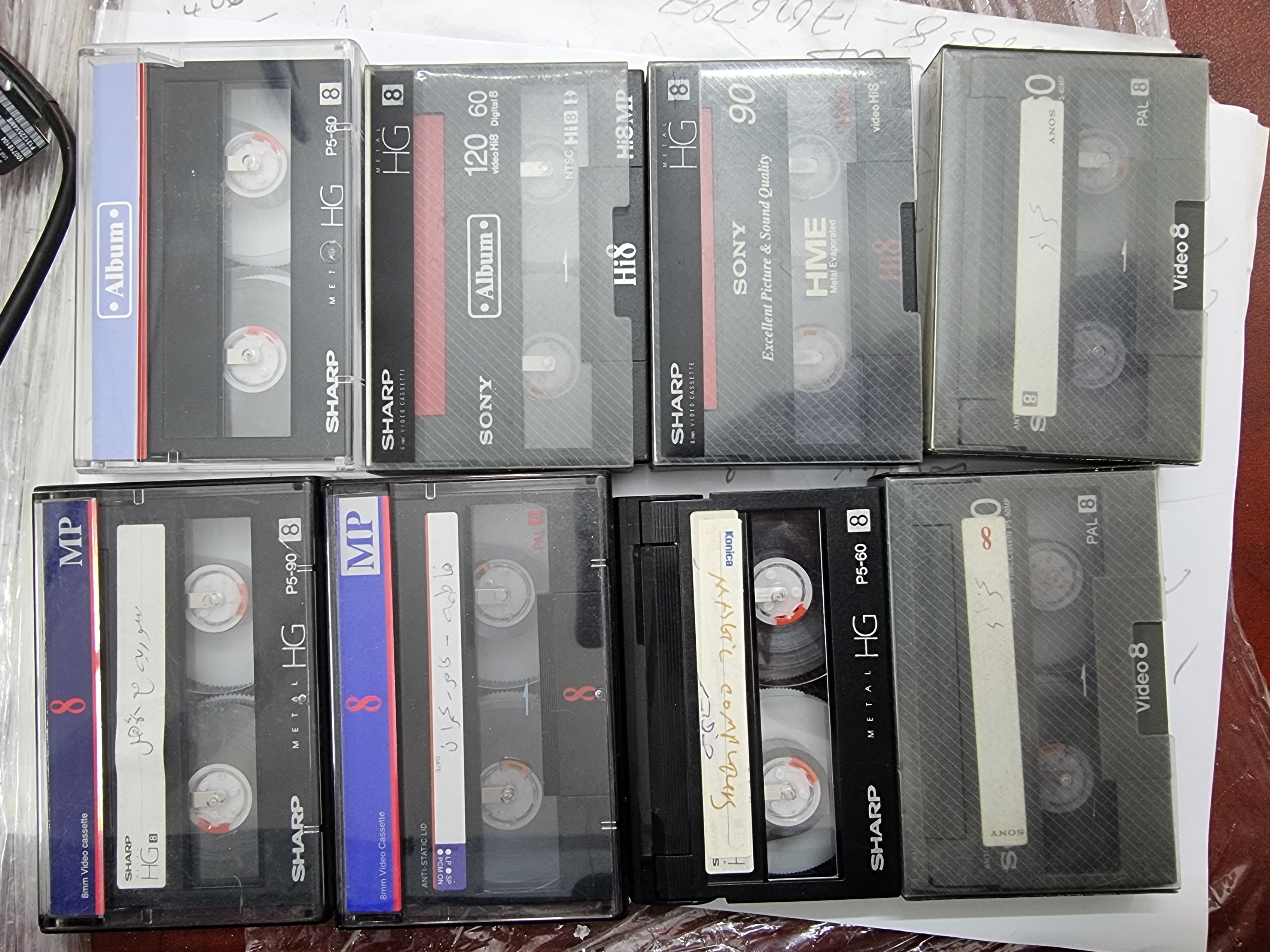

    Just how many tapes do you have ? I appreciate that you have spent money on that capture device. It might have been more beneficial to have asked about that before buying since it is quite limited. You may be better served if you only have a handful of tapes to outsource a transfer service in the UK or Europe eg Germany (not France)
    I see a mixture of 8mm and Hi8. So you would not require a high-end camera as you acquired as NTSC which also supports Digital8. Most of these appear to be PAL

    in fact i have dozens of Video8 tapes in PAL format.
