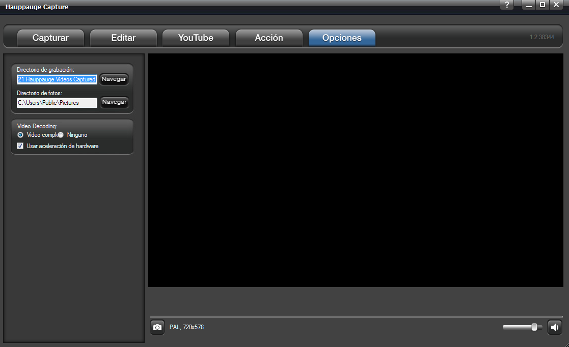

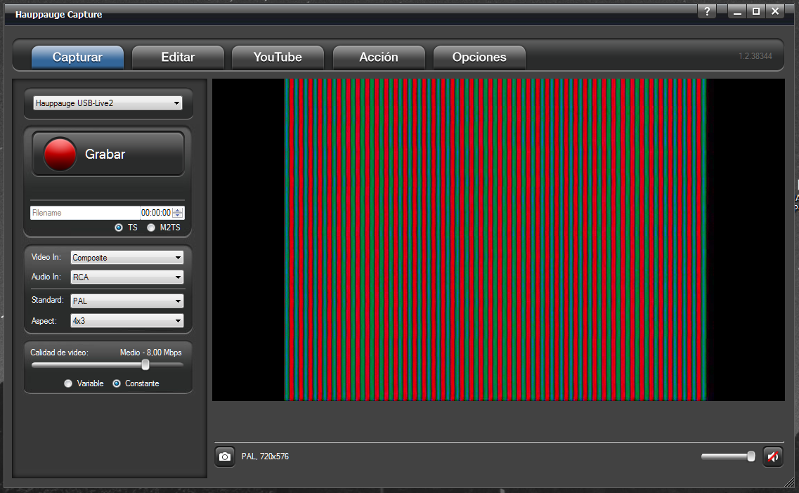

    The problem right now:
    This is the first time I'm testing the USB-Live2 and I have a big issue capturing PAL VHS (kinda same as with EasyCap, but in this case is constant). Not sure if this issue have something to do with my PC since I've test NTSC VHS and the capture was right (this is the standard quality I'm looking for my capturings, indeed).
    (I like the Hauppauge Capture software interface, so I'm using this, downloaded from their site today, same as the driver).
    In my country there's no way to get a TBC or an VHS+DVD-Recorder Combo so I'm not (and I can't) use that - I know this decistion cause issues but this is my only setup aviable by now - But I don't think this have something to do with my issue capturing PAL VHS.
    This is what I get when start the Hauppauge Capture software with PAL option:
    [Attachment 57604 - Click to enlarge]
    (With Honestech software I get just a freeze bugged screen.)

  3. Capturing Memories dellsam34's Avatar
    Jan 2016
    To the OP, It looks from the PAL sample that either you have a SECAM tape a.k.a SECAM-L which you can easily set in the capture software or a MESECAM tape in which case your capture card may or may not be able to capture.

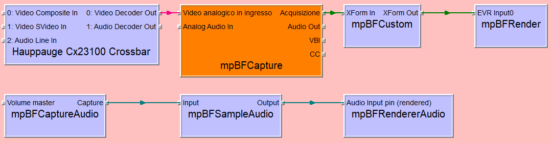

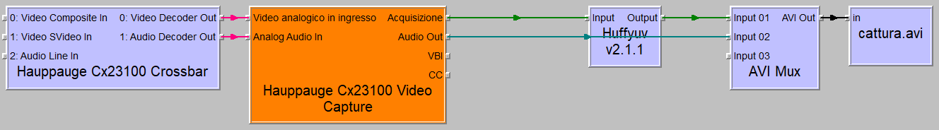

    I do not think that AmarecTV will solve your problem, it just allows you to captures with a lossless codec.
    I mentioned because you can open a Graph in parallel and have a full control of the Hauppage Module. You can also do it inside Amarec, but with the
    Graph you have more options if I remember correctly.
    [Attachment 57620 - Click to enlarge]
    [Attachment 57621 - Click to enlarge]
    Some example: the first is my "home made" capture software that I use sometime, the second is the real
    AmarecTV graph. Select Hauppauge Cx23100 Crossbar and play with the options.

    Although you do not want to go down this route, I do suggest that you install/run virtual dub.
    Select the usb-live as the capture device. Select the 'Capture Filter' from the Video Menu and you should see a Video Decoder Tab. Change that to PAL-N and see if you now have a colour picture in preview. AFAIK the Hauppauge software only supports PAL B/G/I (this is similar to PAL-N except for the color sub-carrier 4.43 MHz as opposed to 3.58 in PAL-N)
    And if you now get a picture I do believe there is other, simpler, capture software that supports PAL-N without going down the lossless route.

    BTW, in my Hauppauge Capture software there's no Video Menu options, just that:
    [Attachment 57631 - Click to enlarge]
    The only difference standards wise with WinTV is that it has an option for PAL-60 (missing in Hauppauge Capture)
    So are you now saying that you can now select PAL-N in other software and see a proper picture ?

    No, you do not have a bad installation. The only options in Hauppauge Capture are 'PAL','NTSC','NTSC_J' and 'SECAM'
    The 'Video Menu' I refered to is in Virtualdub.
