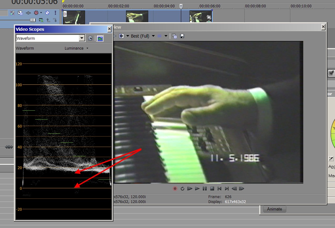

    You need to correct the color. The adjustment needs to be different for the shadows, midtones, and highlights. The first photo shows the histogram before any adjustments. The second photo shows the results of correcting both the offset as well as the color. If you really want to get into it, and your NLE has something similar to the Vegas Secondary Color Corrector, you can target the remaining green on the keyboard and remove that, as I've shown in the third picture.

Name:	Level shift.jpg
