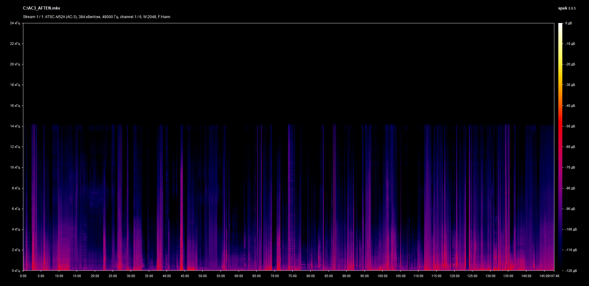

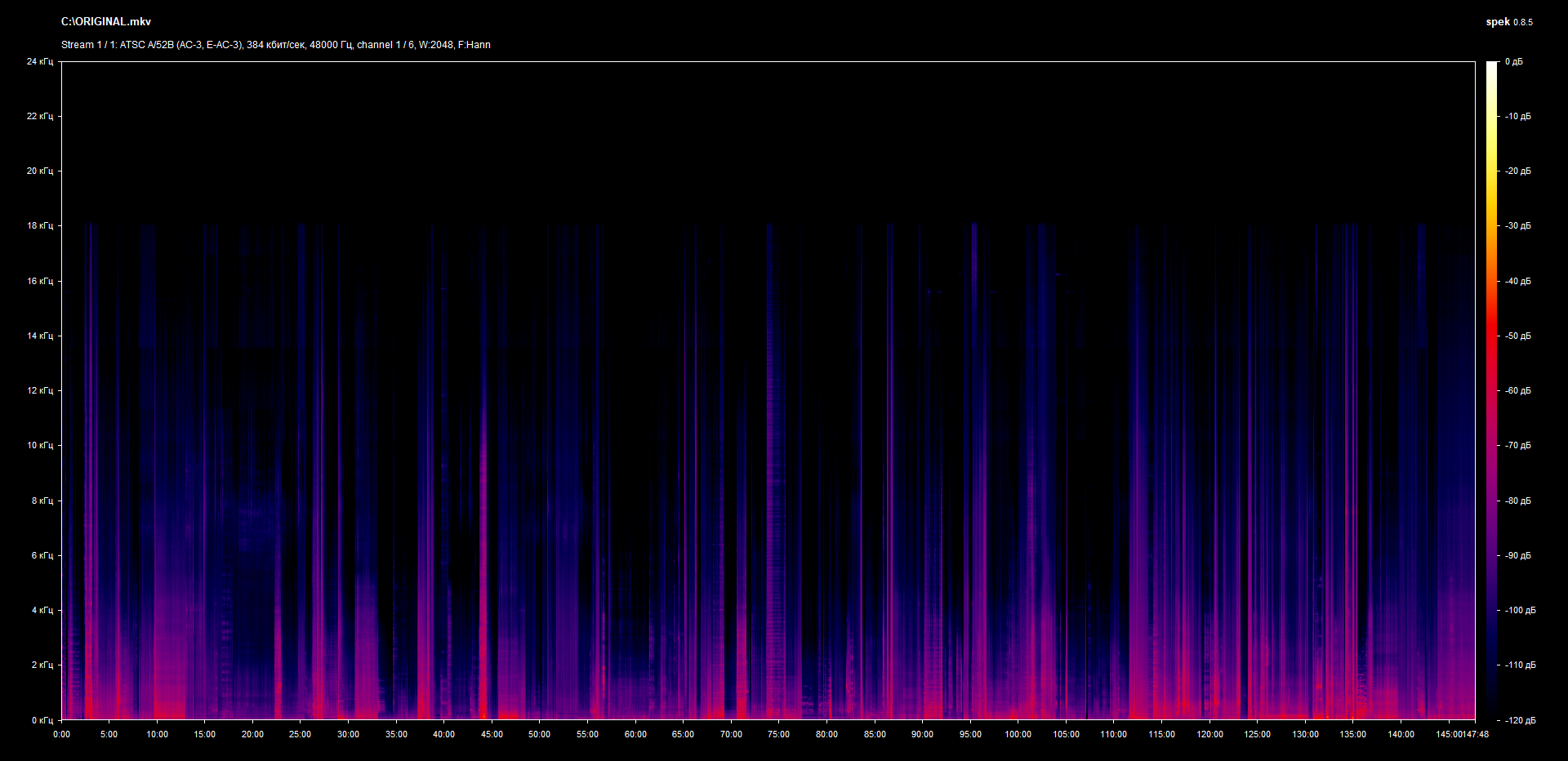

  4. Maybe my answer is quite delayed, but I recently had the same question and came to an obvious conclusion. I needed to encode EAC3 movie audio track to regular AC3 (my old Pioneer receiver doesn't support EAC3). I converted the track in Avidemux using both AFTEN and LAV. After that I opened the files in Spek and noticed that AFTEN lowered the frequency from 18 kHz to 14 Khz and LAV's spectrogram has no any visual difference form the original EAC3. That's why I would never go with AFTEN an will always use LAV.
