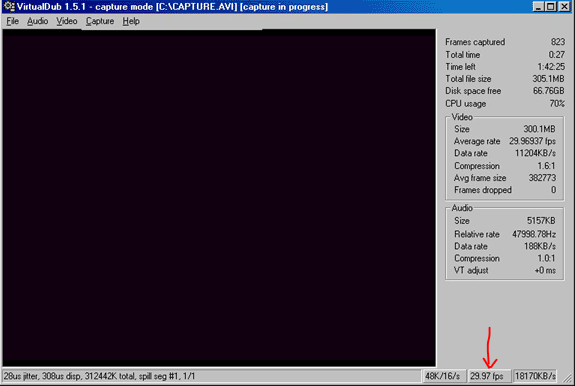

    I'm capturing PAL from cam recorder, I'm using VirtualDub.
    The output video+audio is "high pitched" - the audio and video are in sync, but it is faster than is supposed to be.
    The VirtualDub capture configuration frame rate is 25fps.
    What might be the problem?
    Thanks.
  2. Originally Posted by Kalisto View Post
    Did you check the resulting framerate of your captured video?

  4. Originally Posted by manono View Post
    I just did, The resulting framerate is 29.9fps so this is probably the problem..
    I changed the fps value to 25fps in virtualdub:
    [Attachment 57548 - Click to enlarge]
    Now I have different problem, When I click stop capturing on VirtualDub, The title remains with the text "capture in progress" and VirtualDub gets stuck, The only thing I can do is to kill the process. the output file is corrupted.

  5. Member DB83's Avatar
    Jul 2007
    If you set up vdub correctly to capture at 25 fps you would not get a video at 29.97 fps. The software has no way of knowing the original speed of the tape.
    A PAL tv could play a NTSC tape with no real issues. Not sure whether a 'PAL' camcorder could still film at NTSC speed.
    I do wonder now whether this NTSC/PAL 'confusion' is also a factor for your other topic. There are some switches on the ADVC to select from NTSC to PAL. A NTSC signal should appear as B&W on a PAL selected unit but could, I guess, also result in a blank screen if you set for NTSC with a PAL tape. Not something I can check on my own ADVC since I can not input a pure NTSC signal.
    Oh. And do not compromise quality by capturing with xVID. You can always re-encode from lossless to a distribution format after the capture.
