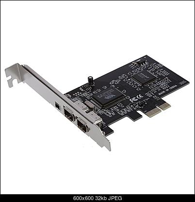

  6. Originally Posted by DB83 View Post
    Link to the firewire card make/model ?
    https://www.aliexpress.com/item/32749028218.html
    Also check that the camera is not at fault by connecting it direct to a composite video playback source.
    The output works, I checked with poor quality usb capturing card.
  7. Member DB83's Avatar
    Jul 2007
    What is this 'Legacy VIA Driver' ? Win7 should support firewire with no addit driver. A legacy driver is sometimes requires for Win10 systems.
    But also do a forum search on VIA firewire chipsets. I do recall reading issues with these. Texas Instrument (TI) chipsets are better but cards are much more expensive that what you appear to have paid.
