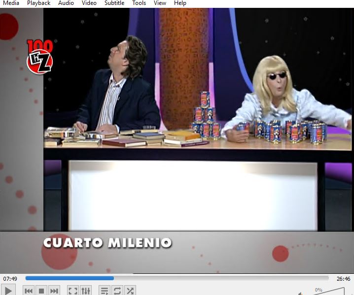

I'm not sure if I understand you correctly. But https://deswowa3player.akamaized.net/vsgtv/_definst_/assets13/2016/11/27/75257449-FA8A...c0e63589c0cf39
can be downloaded without any problem because the URL to the key is valid. It is clearkey, I think. N_m3u8DL can download it. Try it yourself. You'll see it can be downloaded.
https://github.com/nilaoda/N_m3u8DL-CLI/releases/tag/2.9.5 -
It can also download encrypted mpd's. Can one of the tools you named do that?
And I don't mean the modified version of yt-dl. But for this here he can also use yt-dl, streamlink or ffmpeg... It will work.
