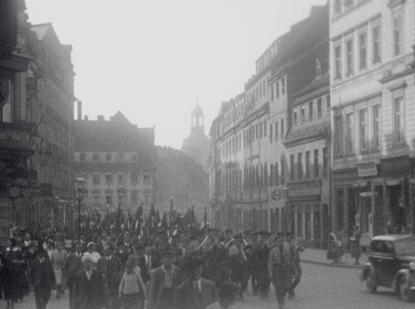

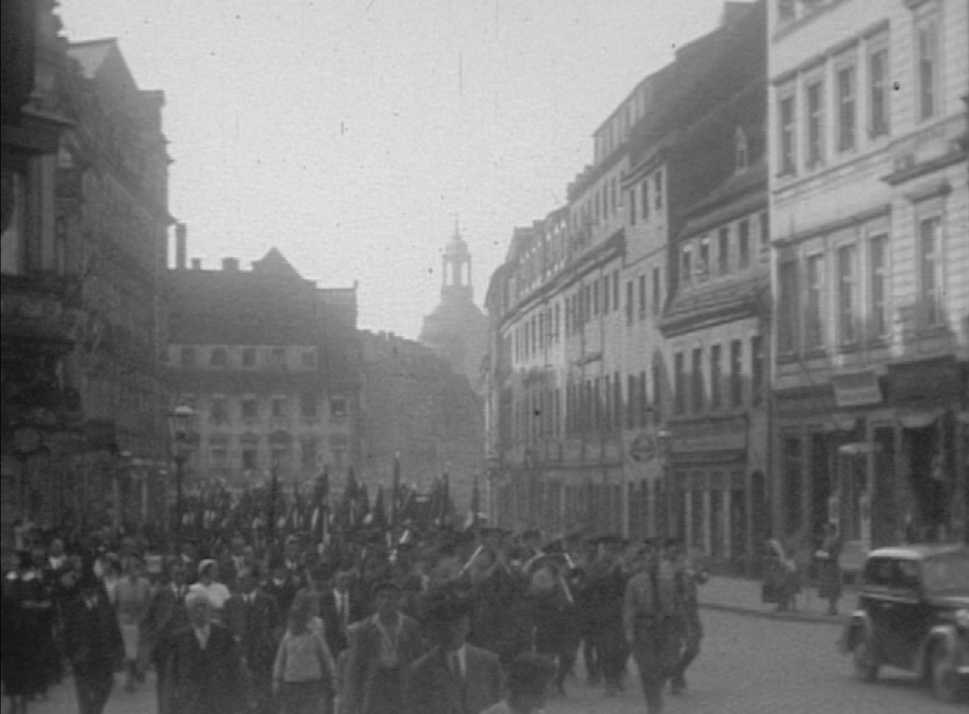

    On a different topic, I have attached two still images, one from the transfer I made, using my own-design transfer system, and the other from Dac Video, prior to my sending it to The Smithsonian Channel. Their transfer is better, but if you zoom in and do comparisons, you will actually not find any additional detail, even though theirs looks crisper. Also, they have a lot more noise. On the other hand, my transfer has some horizontal artifacts because of how my transfer system combines fields from a video camera capturing from a 24 fps projector, while throwing away both the pulldown field as well as redundant fields.
    yea I like their transfer, the first image. Getting that would be worth it to me. Looks way better IMO. thanks for sharing those!
