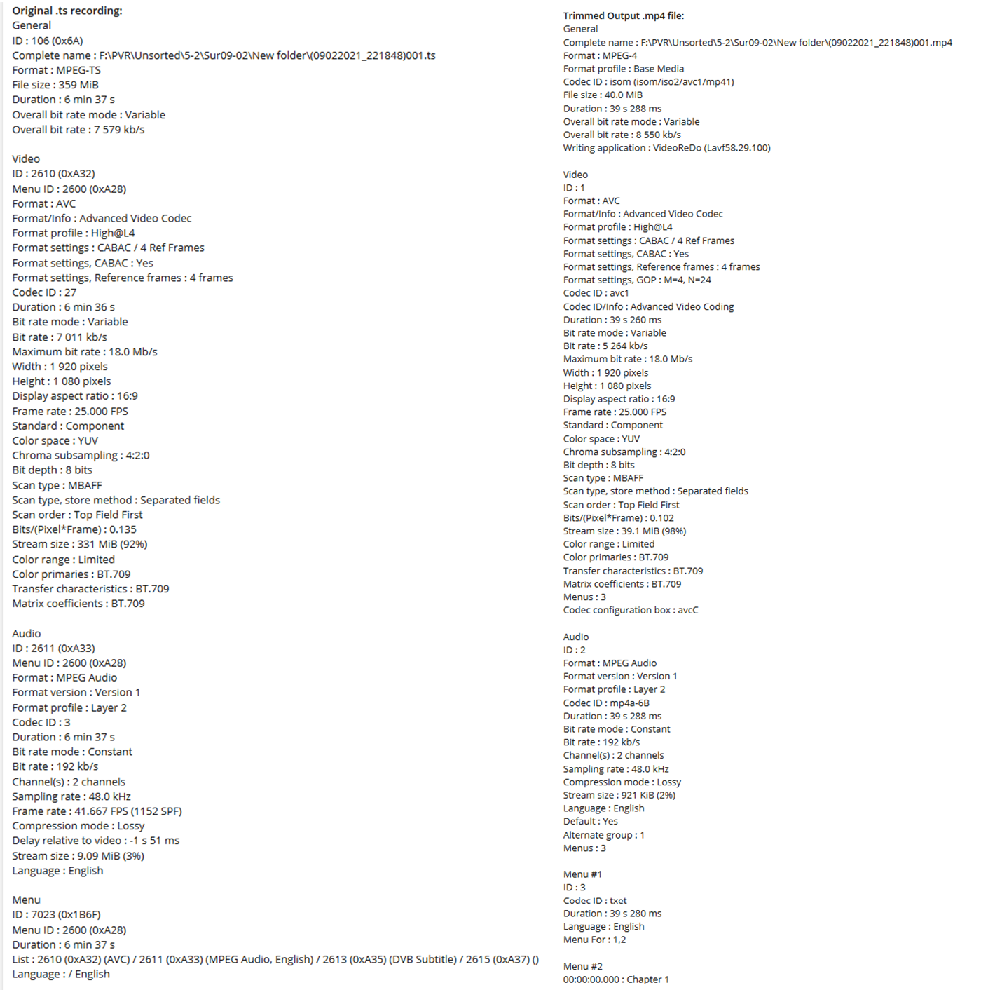

For what is worth, here are two MediaInfo sheets, first of an original .ts recording (which has no issues) then a trimmed snippet of the same recording remuxed in mp4 with Videoredo (which has issues).
[Attachment 57489 - Click to enlarge]

I do not see the info for the ts
It should say: "Scan type, store method : Interleaved fields" for typical "interlace" or mbaff , but yours' says "separated fields."
That suggests double the framerate, as the field rate... when you separate fields for 25fps interlaced you get 50fps indvidual fields -

oh I see you put them side by side in the 1st post
