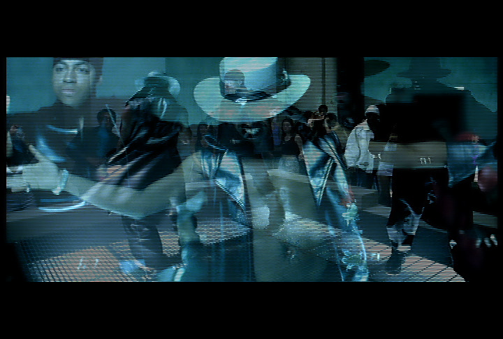

    so you're looking to convert the uploaded 29.97p to 25p? you guys sucked at the conversion in the first place.
    [Attachment 57468 - Click to enlarge]
    really might be too late.

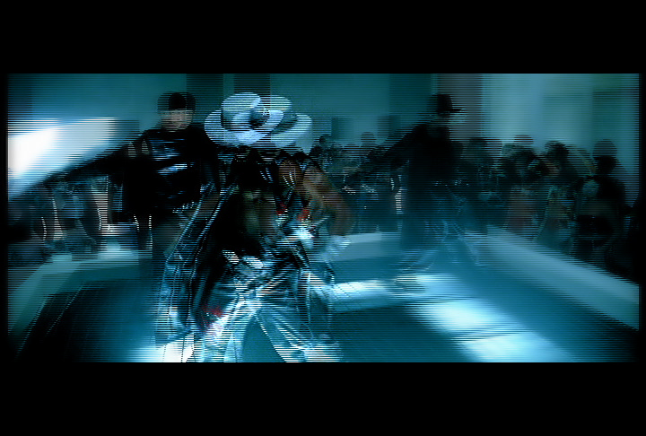

    lol. it's crap. you have 4 de-interlaced/progressive frames followed by 2 frames of blended fields throughout. someone sold you a bill of goods. unless you still have the source material i don't see it getting fixed.
    [Attachment 57470 - Click to enlarge]
    well, just by inverting the pattern, basically field merging every 5th frame. It is a pattern, as simple as it used to be put in and when the plug in was around it was of course reversible within seconds, it just applied the reverse order to combine the 2fields within the sequence to a progressive frame. Actually simple, just that there is no simple software around that has the option to not only do an inverse 3:2 pulldown, but also a 4:2 one.
