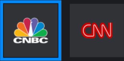

    On Demand Logos
    Old/New Beta Elgato Driver
    [Attachment 57440 - Click to enlarge]

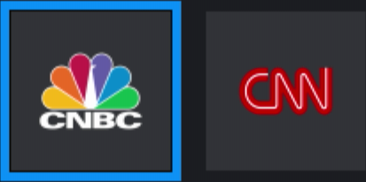

    New (non-beta) Elgato Driver
    [Attachment 57441 - Click to enlarge]

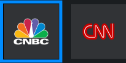

    Live Gamer 4K
    [Attachment 57442 - Click to enlarge]

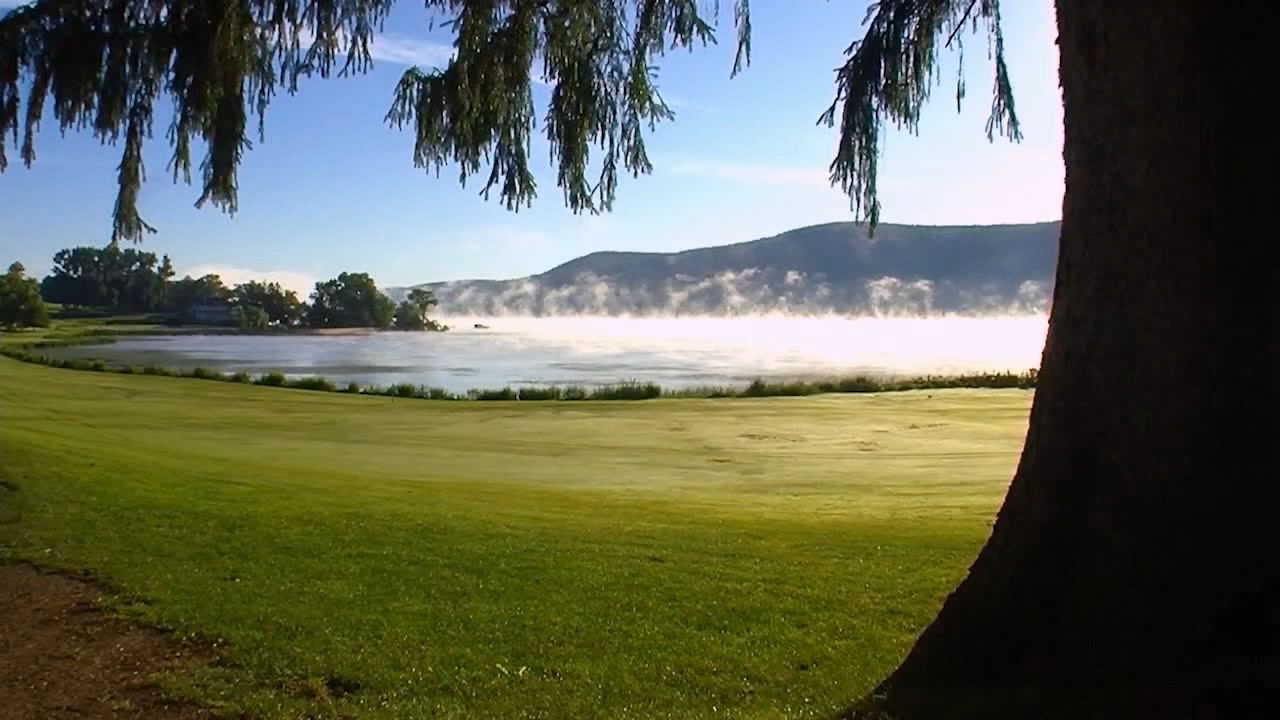

    Live Shows
    [Attachment 57446 - Click to enlarge]

    Is there any way I can check and see if my cards are displaying in the right color matrix or not? Which one's correct and which one's not? I can send example videos if anyone wants any.

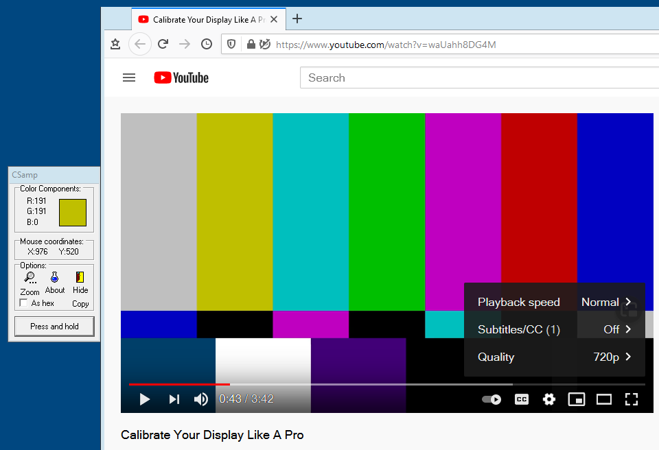

  2. Can you play youtube content on your source? This video has standard 75 percent rec.709 (aka bt.709) HD colorbars at about 45 seconds in:
    https://www.youtube.com/watch?v=waUahh8DG4M
    When displayed correctly the bars' RGB values should be 0 or 191, plus or minus 1 or 2. You have to make sure your player (cable box? satellite box?) isn't "enhancing" the playback in any way.

    It had the correct rec.709 colors when I looked at it last night. This morning I see bad colors. I see what's happening: if you view the video in a browser in a small windows you get one of the lower resolution videos with the wrong colors, if you view in a large enough window the colors are correct. The 480p and lower resolutions give the wrong colors, the 720p and 1080p resolutions give the correct colors. If you download the SD or HD videos and display them correctly as rec.709 you get the correct colors.
    [Attachment 57457 - Click to enlarge]
    But yes, this can be browser and graphics card dependent so you should verify the on-screen colors on your own system. In any case the downloaded videos have the correct rec.709 YUV colors.

    No. If you are viewing this correctly on a computer monitor you should see RGB components of 0 or 191. We've been through all of this before.
