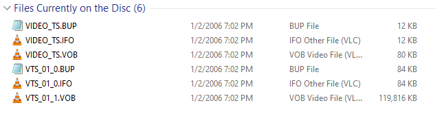

 You are correct. In fact I have two VOBs under the VIDEO_TS folder (I tend to ignore the VIDEO_TS.VOB). The full directory structure is shown below:
 [Attachment 57398 - Click to enlarge]

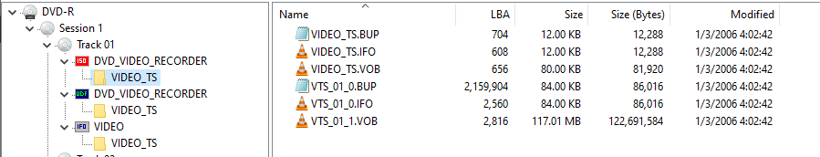

 I followed your advice and downloaded/ran ISOBuster. Very interesting tool. This is the information it provided me from the get go:
 When selecting ISO DVD_VIDEO_RECORDER > VIDEO_TS I get the following information

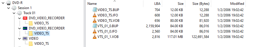

 When selecting UDF DVD_VIDEO_RECORDER >VIDEO_TS, I get the following information
 [Attachment 57400 - Click to enlarge]

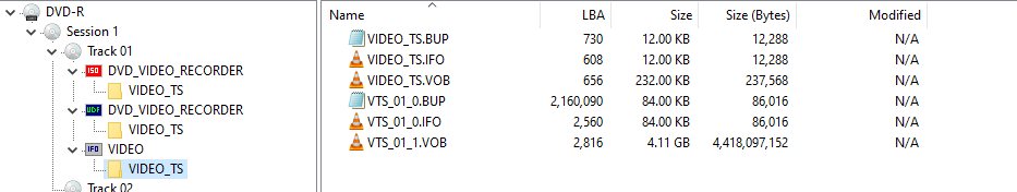

 When selecting IFO VIDEO > VIDEO_TS, I get the following
 [Attachment 57401 - Click to enlarge]
 The size of the file VTS_01_1.VOB in the two first pictures is 117MB, while it is 4.11GB in the third picture. Possibly a clue!

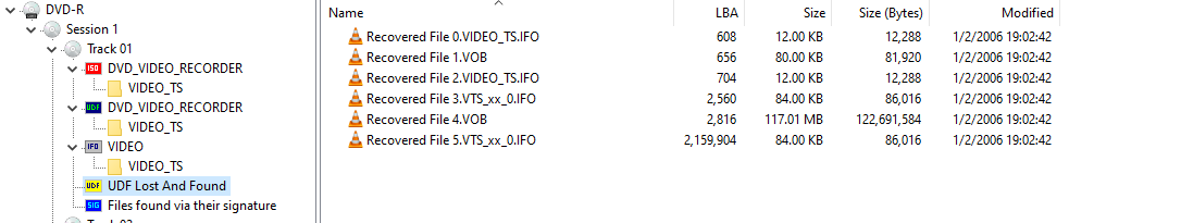

 Under UDF Lost and Found I see the following

 The picture of the files under SIG shows a recovered VOB file of size 4.11GB, which is the same size of the file found under IFO VIDEO > VIDEO_TS above. Maybe the missing video? Right clicking on the file gives me the option to extract it but the option only works for a licensed software.
 I am more than glad to pay for software license but would appreciate if you could confirm that I followed the correct process and that extracting the file would likely give me the full video. Once I have the VOB, I can easily convert it to MP4 using Handbrake.

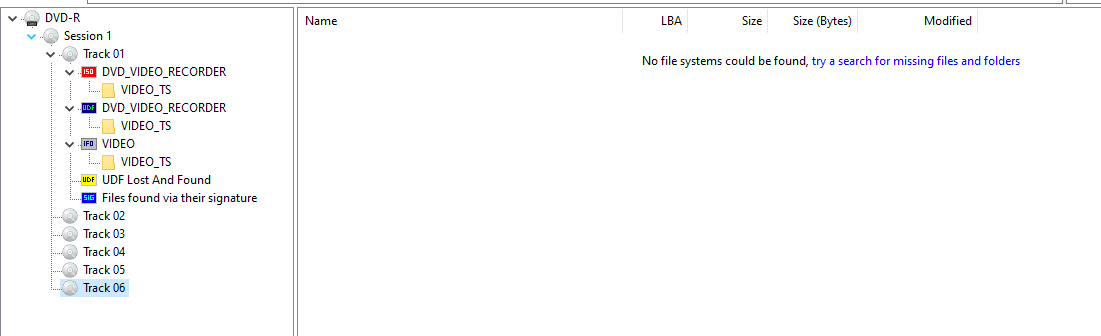

 Thank you. In fact, there are 6 tracks listed. See picture below:

 I am not sure what they mean: Are they "Titles" or "Chapters"? I can play the full 2 hours in VLC and I can see in VLC 1 Title with 24 Chapters. It *looks like* there was a problem when the DVD was written/closed/finalized and the VOB metadata was not updated, even though the media had already been written (?).

 Yes, the presence of 6 track segments certainly would confound the OS's understanding.
