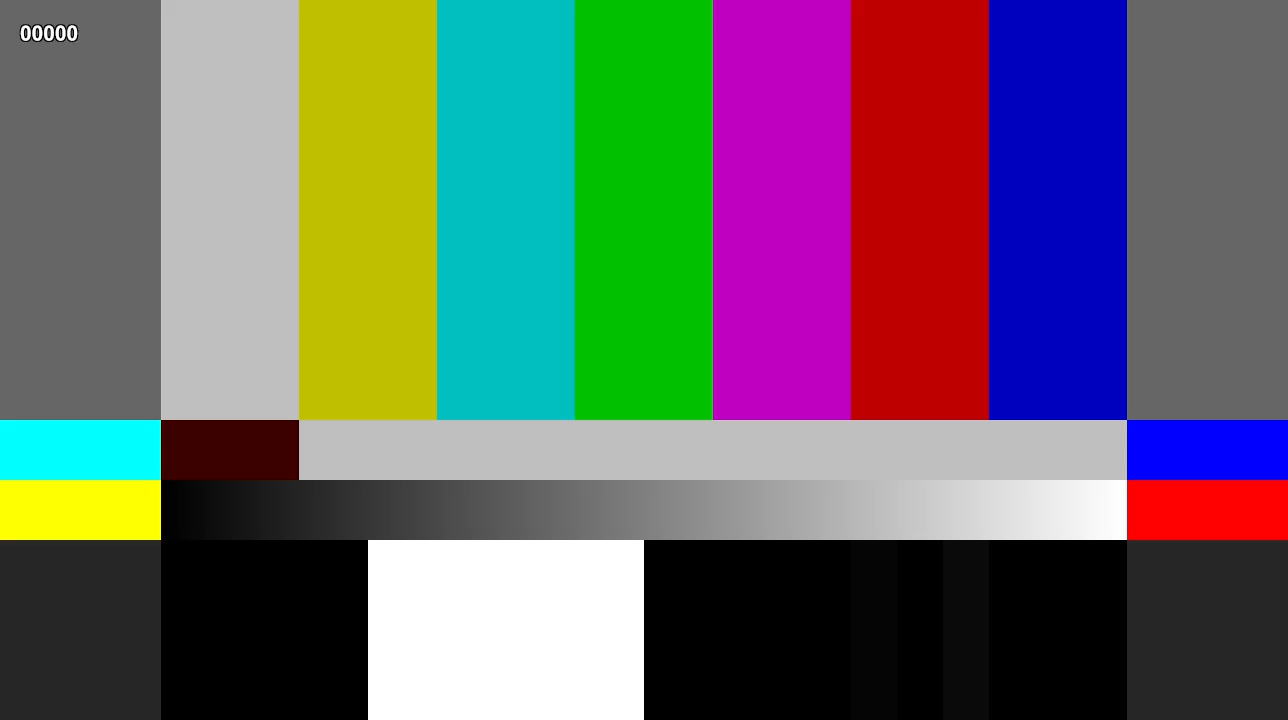

 Here's a standard 75% colorbar test pattern encoded and flagged as rec.709 you can use to test. The color bars should have RGB values of 0 or 191 (plus or minus 1) when displayed. The small bright color patches should be RGB 0 or 255 (plus or minus 1). The black level pluge patterns near the bottom center/right should be RGB 0, 5, and 11. Correctly displayed it should look like this:

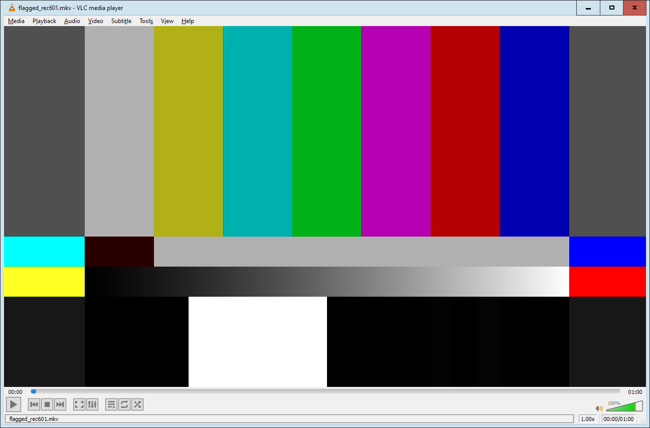

 But I just played a similar rec.601 test chart with VLC and it produced slightly wrong colors and levels. A screen cap:
 [Attachment 57385 - Click to enlarge]
 I wish they would get their act together. It's a little better now but they've had these color problems for at least 10 years.
