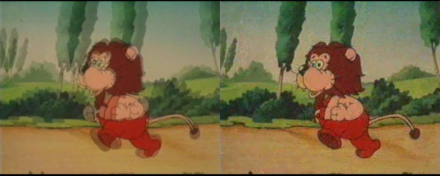

  21. Originally Posted by Okiba View Post
    Just out of curiosity. Today's computer generated animation (where you don't have to hand-drawn every frame). Are they also at 24fps?
    Usually.
    I have a single video I gave up on because it wasn't important that has crazy frame blending. I could see it very often. SRestore wasn't able to solve it, so I assume someone just did a mistake a long the road. Is there anything else I could have done besides Srestore? I can share it if it's interesting enough, but I gave up on it myself.
    EDIT: Oh what the hell. I'll attached it. Might be educational.
    The video alternates between progressive frames for a while then 50:50 blended frames for a while. Since a blended frame is produced by averaging two adjacent frames, B = (X+Y)/2 (B = blended frame, X = one frame, Y = the next frame), X can be restored by reversing the procedure if you have a clean Y, X = (B-Y/2)*2. In practice, compression artifacts and limited granularity of 8 bit video make this unfeasible. For example, here's frame 11 (blended) restored by subtracting the clean frame 12:
    [Attachment 57669 - Click to enlarge]
    src = Mpeg2Source("Blended.demuxed.d2v", Info=3)
    next = src.Trim(1, 0) # ie the next frame
    Overlay(src, next, mode="subtract", opacity=0.5).ColorYUV(gain_y=256, cont_u=256, cont_v=256)
    That's the original frame 11 on the left, the restored version on the right. As you can see the result is pretty noisy. And frame 10 has to be restored by subtracting the cleaned frame 11, not the original frame 11, resulting in even more noise (not done by this script). The more consecutive frames you have to unblend like this the noisier they are going to get.
