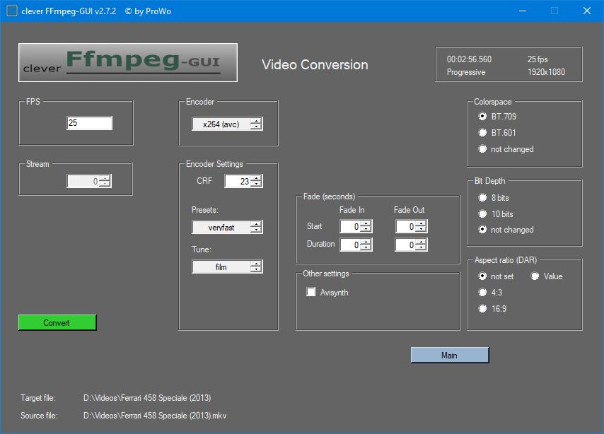

  21. You can do the whole operation with my clever FFmpeg-GUI.
    Load your file, main, modify video stream, continue, check Avisynth, create script. A basic Avisynth script is created. Modify them as you like, test it with virtualdub2 , set the encoder you like, set DAR to 16:9 and click convert. Then click on multiplex, the new created videostream is already loaded as video file, click on Audio file, accept the proposed file (your original file), set the container (mkv, mp4) you like, click multiplex, ALL DONE.
    [Attachment 57423 - Click to enlarge]

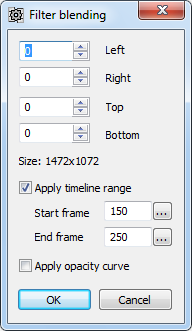

    There's actually another way in Virtualdub, I only just found out about it myself today.
    Set up the resize filter, highlight it in the list then select the "Blending" button on the right -
    allows you set a frame range it should apply to.
    See Antons post on 2020-03-23
    https://sourceforge.net/p/vdfiltermod/tickets/314/

  27. Member
    Mar 2008
    That's strange it worked for me using build 44282
