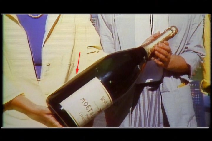

  1. I'm trying unsuccessfully to solve edge haloing/ghosting (whatever it could be named) problem with different videos.
    Below the sample from DV tape video, captured using FireWire and processed using: FFmpegSource2("clip.mov").QTGMC(Preset="placebo")
    https://drive.google.com/file/d/1zNPRN7-WKd7kTA_Fs3GggkzZ2to5ThhA/view?usp=sharing
    Another samples - from the Betacam tape video, captured using AJA and processed using:FFmpegSource2("clip.mov").Crop(0,4,-0,-2).QTGMC(preset="fast").SRestore(frate=23.976)
    https://drive.google.com/file/d/1InYCBFdGlukwatttu34Svc5QAc3BaeFY/view?usp=sharing
    https://drive.google.com/file/d/10yrYsdASeMj6rEMuSyCCn1L2brcTory0/view?usp=sharing
    As you can see the - the video from Betacam introduces two different (kind of) halo/ghosting.
    I tried many de-halo/Ghost filters (too long to list) that I could found.
    The last one I tried is the approach posted at: https://forum.doom9.org/showthread.php?p=1177500#post1177500.
    Unfortunately the author did not disclose the whole script, and the part of the disclosed script doesn't match the result, posted in that thread.
    Any suggestion greatly appreciated.

  2. First of all, turn off any sharpening filters in any of your hardware. Those are the cause of the halos -- avoiding them is better than reducing them in post.
    There are dehalo filters for AviSynth but they can be pretty damaging to the video.
    dehalo_alpha(rx=3.5, ry=1.0, DarkStr=1.3, BrightStr=1.3)
    dehalo_alpha(rx=1.0, ry=3.0, DarkStr=1.6, BrightStr=1.6)
    [Attachment 57376 - Click to enlarge]

  8. Managed to make it work (somehow) using mask:
    clip= last
    dehalo = clip.dehalo_alpha(rx=3.5, ry=1.0, DarkStr=1.3, BrightStr=1.3).dehalo_alpha(rx=1.0, ry=3.0, DarkStr=1.6, BrightStr=1.6)
    emask = clip.mt_edge("min/max",4,48,0,255,U=-128,V=-128).mt_invert(U=2,V=2)
    result = mt_merge(clip,dehalo,emask, U=2,V=2)
    return(result)
    Any suggestions to improve it?

  12. Ended up with:
    emask = clip.mt_edge("min/max",4,48,0,255,U=-128,V=-128).mt_invert(U=2,V=2).Move(0,0,HDir=2,VDir=4,Bor dCol=$FF0000)
    result=mt_merge(clip,dehalo,emask, U=2,V=2)
    Where "Move" from StainlessS post https://forum.doom9.org/showthread.php?p=1718440#post1718440
