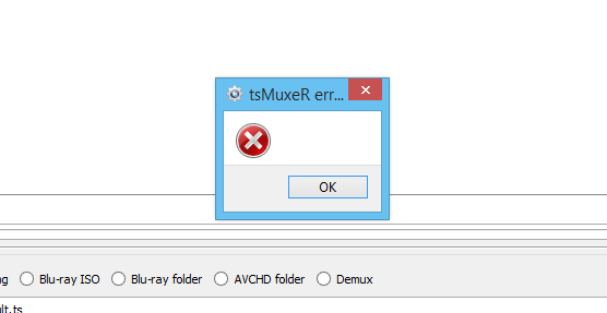

    If you have a video with 4.2 Format profile load it into tsmuxergui and change level from 4.2 to 4.1 and start muxing and load the ts into mkvmerge and start muxing as mkv,no need to re-encode,this won't work with video that are 2k and higher since they won't play in tvs that have 1920x1080 as the max resolution.
  10. Thank you all for your replies
    @Sharc & johnmeyer: Still looking for the manual online
    @johns0 tsMuxer is not opening the file
    gives me an unspecified error message
    [Attachment 57366 - Click to enlarge]

  11. I'm a Super Moderator johns0's Avatar
    canada
    What version of tsmuxer are you trying?
  12. Originally Posted by johns0 View Post
    tsMuxeR 2.6.12 Windows
  13. I'm a Super Moderator johns0's Avatar
    canada
    Try remuxing with mkvmerge and then remux with tsmuxer with the profile change.
