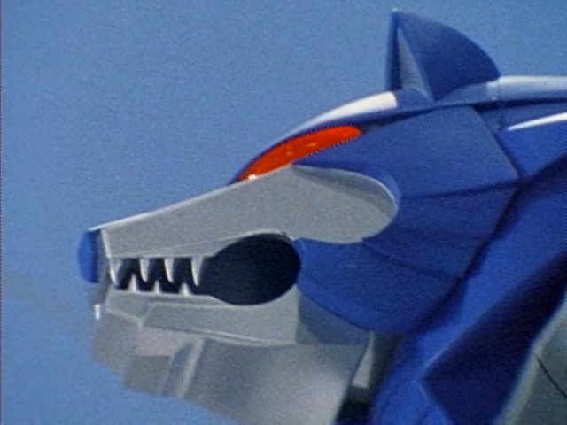

  1. How do i remove these tiny dots around the corner of the eyes?
    [Attachment 57335 - Click to enlarge]
    I tried Destripe(2,1,100) and it didnt remove the dots.
    Sry, I don't know the term of the problem but Help please.
  2. You want to use a "dot crawl" remover. With fuzzy VHS you can reduce the image width to half, the resize back to full size.
  3. I used DeDot(luma2d=20, lumaT=60, chromaT1=0, chromaT2=255) and it was still the same. also the latter part reduce and resize back doesnt work too. Help me
  4. As usual, upload a sample.
  5. This reduces them then considerably without damaging the picture too much:
    BilinearResize(width/2, height).Spline36Resize(width,height)

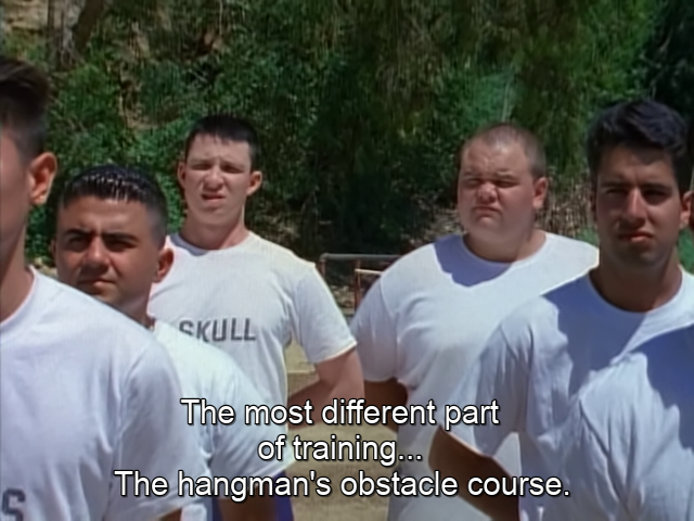

  6. wow great thanks, it does reduce them moderately but it seems a little blurry but didnt have much impact like the dotcrawl remover. I have faced another type of vertical dots in which i can't remove.garage verticaldots.m2v In fact most of those DVDs seem to have a lot of vertical dots like in the sample [especially outdoor scene]. Anyway to remove with least information loss?
    [Attachment 57359 - Click to enlarge]
    Look at the trees behind them. They don't seem very smooth and i feel harden vibes coming from them. Is that vertical roughness the same as the sample garage scene?

    The issue with the garage door is not related to dot crawl. It's just aliasing/moire that occurs when the frequency of the signal approaches the frequency of the sampling. I don't think there's a lot you can do for it other than blur it away.

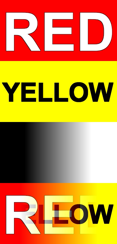

  11. I had a little time so I put together a small example:
    #  Build a 256x256 RGB video with grey shades
    #  ramping from 0 to 255, left to right
    function GreyRamp()
       BlankClip(color=$000000, width=1, height=256, pixel_type="RGB32")
       StackHorizontal(last, last.RGBAdjust(rb=1, gb=1, bb=1))
       StackHorizontal(last, last.RGBAdjust(rb=2, gb=2, bb=2))
       StackHorizontal(last, last.RGBAdjust(rb=4, gb=4, bb=4))
       StackHorizontal(last, last.RGBAdjust(rb=8, gb=8, bb=8))
       StackHorizontal(last, last.RGBAdjust(rb=16, gb=16, bb=16))
       StackHorizontal(last, last.RGBAdjust(rb=32, gb=32, bb=32))
       StackHorizontal(last, last.RGBAdjust(rb=64, gb=64, bb=64))
       StackHorizontal(last, last.RGBAdjust(rb=128, gb=128, bb=128))
    alpha = GreyRamp().AddBorders(64,0,0,0,color=$000000).AddBorders(0,0,64,0,color=$ffffff).ConvertToYV12(matrix="pc.601").Crop(0,0,-0,-56)
    red = BlankClip(alpha, color=$ff0000).Subtitle("RED", size=195, y=8, text_color=0)
    yellow = BlankClip(alpha, color=$ffFF00).Subtitle("YELLOW", size=95, y=55, text_color=0)
    Overlay(red, yellow, mask=alpha)
    StackVertical(red, yellow, alpha, last)
    That script builds three images, a red background with white text, a yellow background with black text, and a ramp of grey values. It then overlays the yellow image over the red image using the grey ramp as an alpha (transparency) mask. The three images and the overlay result are show, stacked vertically:
    [Attachment 57406 - Click to enlarge]
    In the final result you can see that the red image appears at the left where the alpha mask is totally black, the yellow image appears at the right where the mask is totally white, in between there is a mix of the two where the weighting depends on the shade of gray in the mask.
    In the earlier script I used properties of the image to build an alpha mask. One mask of edges, another of highly saturated areas, then a multiplcation of the two to produce a final mask of edges near colorful areas.
