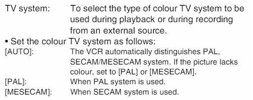

    PAL vcrs will not handle SECAM (...)
    You are not right, my Panasonic NV-HS930 handles SECAM:
    [Attachment 57339 - Click to enlarge]

    Most of 90's and 2000's French VCR's handle both SECAM and PAL without any problems, JVC's have the extension MS at the end of the model such as HR-S9600MS. Early models supported SECAM only a.k.a SECAM-L.
