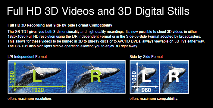

    the mts file definitely has 2 video streams but nothing i have can access the second. i'd guess the jvc 3d software that came with cam is the only way. i'd try shooting some half sbs rather than the full sbs your files are, and then see if the software can export it to 1920x1080 hsbs that would be viewable on a 3d tv.

    [Sorry, it's late, and evidently I can't read the two times you posted it was the GS-TD-1! Sorry. In 2023, still looking for an easier way than using that janky old software. MVC to AVI is an option, but is 29 euro.]
    "I bought an old stereo/3D video camera"... Would you happen to have the model number of the camera? JVC made a consumer version and a pro version. The consumer version is much more difficult to extract the full frame version. If you could verify whether you have the GS-TD1 or the GY-HMZ, I'd appreciate it. Thanks.
