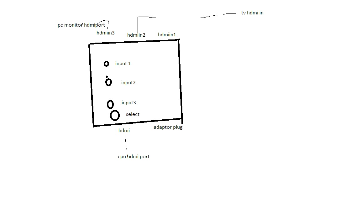

    will the issue solve, if i use hdmi one to two splitter, from the cpu, one connecting to pc and the other to tv, and passing audio signal as at present, selecting duplicate monitor.
    I am having only one hdmi port in the cpu
    Thanks for your tips of s/pdif connection.
    it is a digital audio output connection between tv and speaker.
    if that is the case, should a need a kind of audio splitter , one to two, one connecting to the tv and other other to pc.

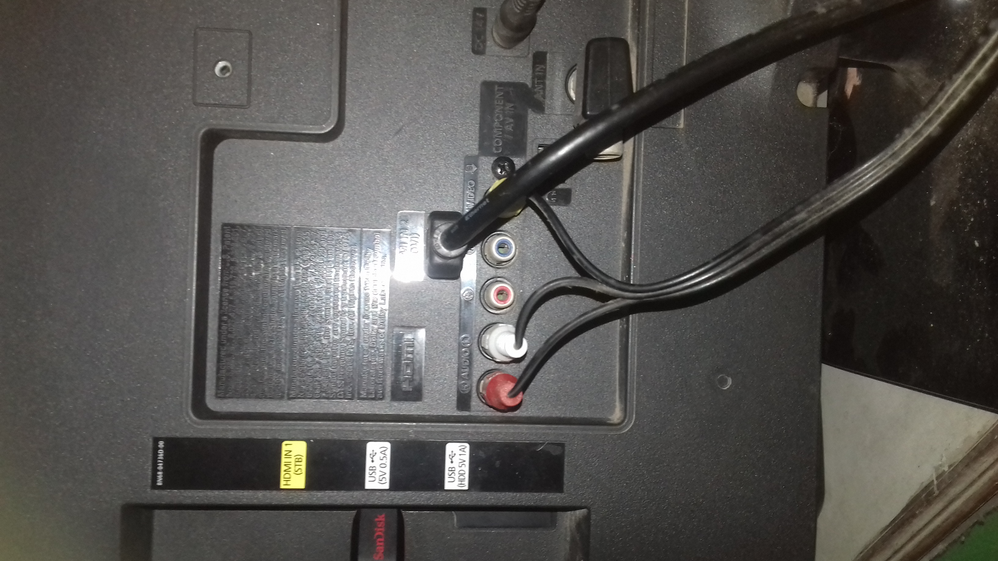

  14. Member jraju's Avatar
    Mar 2013
    India
    Hi, I managed to zoom the relevant portion of the page from my model pdf .
    i do find hdmi 2 and also hdmi 1 out, but could not locate at the back of the tv.
    now , you could advise me clearly how to go about, jagabo.
    Technician says that my tv does not have dvi port in the model
    there is already a cable in the hdmi3dvi port, probably for cable connection for av and hd consumers

  15. What makes you think your TV has HDMI out? DVI and HDMI are the same signal, just different connectors. You can use a DVI to HDMI converter cable -- just like the manual shows.

    Hi, jagabo, now i understand , the output is the other device . Thanks
    But, souce button in tv shows hdm12, as something is connected to the tv, as you sya hdmi dvi port.
    i do not have any dvi port in the pc to connect to.
    i did connect the first connection near the usb port, ie hdmi1-in to the hdmi port available in the back of pc.
    But it was said that this port is available only for channel of set top box.
    I sent the picture , as well said that sourceing either av or hdmi2 give the cable tv shows .
    how do i get the audio in the tv as well
    as hdmi1- in connected with hdmi-in port of pc, there should not be any problem in getting the audio on both source.
    i will look in to tv tools or settings to enable anything .

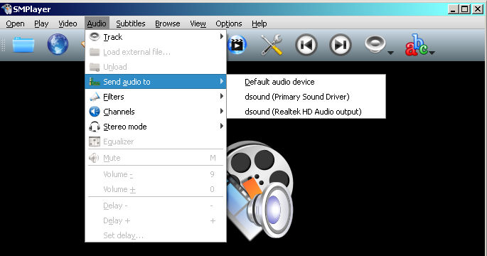

    Another thought I had, assuming your video card includes sound, is whether you could set the PC to "speakers" as the default, and use a player that allows you to select a particular audio device. If it works, in theory the audio from the player should be sent to the TV while everything else uses the PC's sound card. Once again, I can't test it.
    VLC and SMPlayer have an audio menu for selecting the audio device. For MPC-HC it looks like you need to choose the audio device under Options/Playback/Output.
    [Attachment 57379 - Click to enlarge]

    Hi, Jagabo,
    I hava a 3to 1 hdmi siwitch with adaptor to connect tv and other devices with my pc. As I have only one hdmi port in the graphics card, i want to try this one to connect to my pc and tv first.
    I have a query.
    When i connect, the hdmi cable in to the input 1, after connecting the hdmi cable with the hdmi switch, having only one port with the cpu hdmi port. and then connecating the hdmi cable from input 1 to pc back hdmi port, i am not able to boot to see the display. No light is either glowing on the hdmi switch, but the adaptor lilght is glowing green.
    Will the light glow, when an input is connected or should we press the selector button. No light is glowing if i press the selector button on any input port.
    Why
    Am i right in connecting pc monitor with input one, and the tv in the second output.
    or am i wrong.
    i enclose the witch i bought along with the connection . please say , why my hdmi not glowing when i test cpu to monitor thro the hdmi switch as enclosed in the pic

  23. It looks to me like you are using that switch backwards. The way you've labeled the diagram it has three inputs and one output. That means it's for connecting three different HDMI sources to one TV, not for connecting one source (your computer) to three different devices (TV, monitor, capture device, whatever). If it's a mechanical switch that's ok. But if it's electronic it shouldn't work at all.

  25. You need an HDMI splitter like this:
    https://www.amazon.com/HD-102-Powered-Splitter-Certified-Support/dp/B005HXFARS/
    It has one input. Whatever comes in that HDMI port goes both HDMI outputs. So your computer's HDMI output will go to both the monitor and the TV.
    power supply --------->|    HDMI Splitter      |
                           |            HDMI OUT 1 |----> TV HDMI IN
    computer HDMI OUT ---->| HDMI IN               |
                           |            HDMI OUT 2 |----> Monitor HDMI IN
