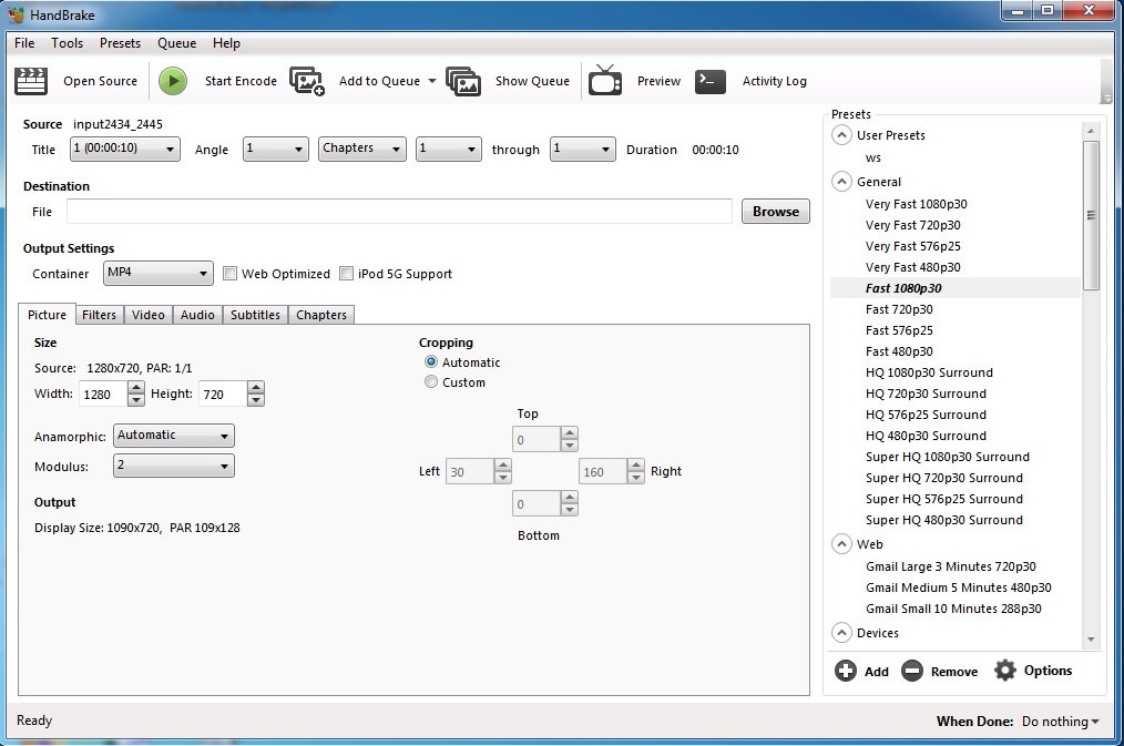

  17. Member DB83's Avatar
    Jul 2007
    Select 'custom' instead of 'automatic' on the cropping dialog and reset the numbers to 0
    [Attachment 57287 - Click to enlarge]
  18. Originally Posted by DB83 View Post
    Indeed this works!

    To the left it crops till it reaches the left edge of the broadcaster's logo, to the right it varies according to the aspect ratio of the inserted black & white source material, hence the SARs vary. Unfortunately it crops everything, also the normal 16:9 sequences, to the right probably up to the widest black band it could find, squeezing the overall result horizontally. It's just the consequence of the algorithm in Handbrake to automatically crop black bands, even if, in this case, it shouldn't have done so.
    The chunks which I tested and were normal indeed only contained 16:9 material, the problematic chunks contained a mixture, and consequently their SARs varied.
    Conclusion: Disable Automatic cropping and set eveything to 0 with the Custom option when the source video to be rescaled/recompressed contains a mixture of material with varying aspect ratios.
