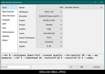

    FYI, this is a basic NVEnc H264 options setting for my GTX 1060 6G (Pascal) card.
    Just think of it as an example. You need to take a lot of things into account other than these options reflecting the features and properties of the source video and your graphics card.
