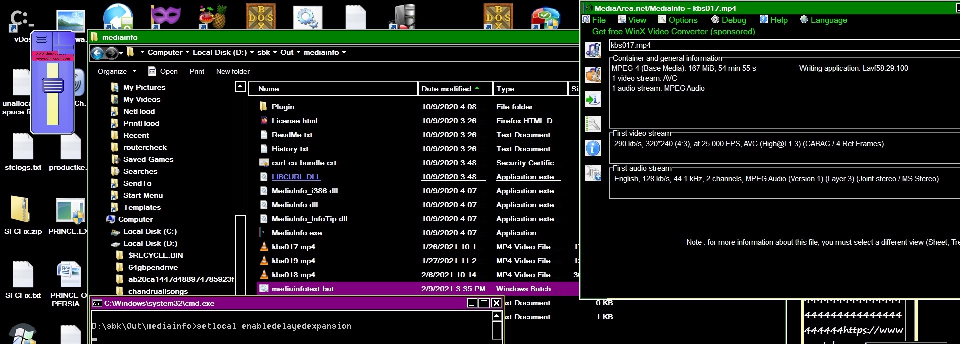

    please find enclosed the result
    Am I making some mistake
    what i really want is to show only the files that are not matching with the first file.
    I do not have any other extension other than mp4 and these may contain different video and audio outputs.
    what i need is , check video and audio codec, that will be listed as first file, the formula may check the match of codecs with this file , and if found difference in codec, list the file that differs.
    The result file codec txt contain the file name, of all files in the folder and it also opens the media info gui screen.

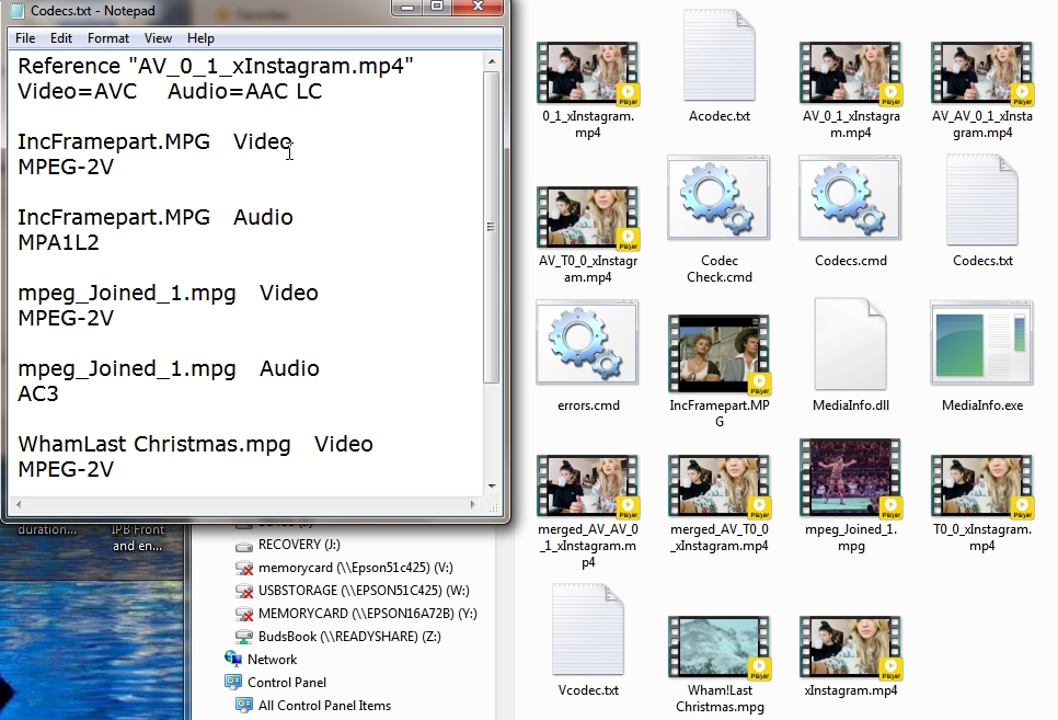

    This will create 3 folders. Acodec.txt for saving Audio codec, VCodec.txt for saving Video Codec for each file, and Codecs.txt which lists your reference file, its codecs and then lists all other videos that are different and their codecs. Right now as it is it checks "for %%b in ("*.mp4","*.mpg","*.mkv") Do (" files.
    If you want to you can change it CAREFULLY to "for %%b in ("*.mp4") Do (" but it really doesn't matter since you have only MP4's in the folder it will not find any MKV or MPG files. I only added so I could show the files with different codecs.

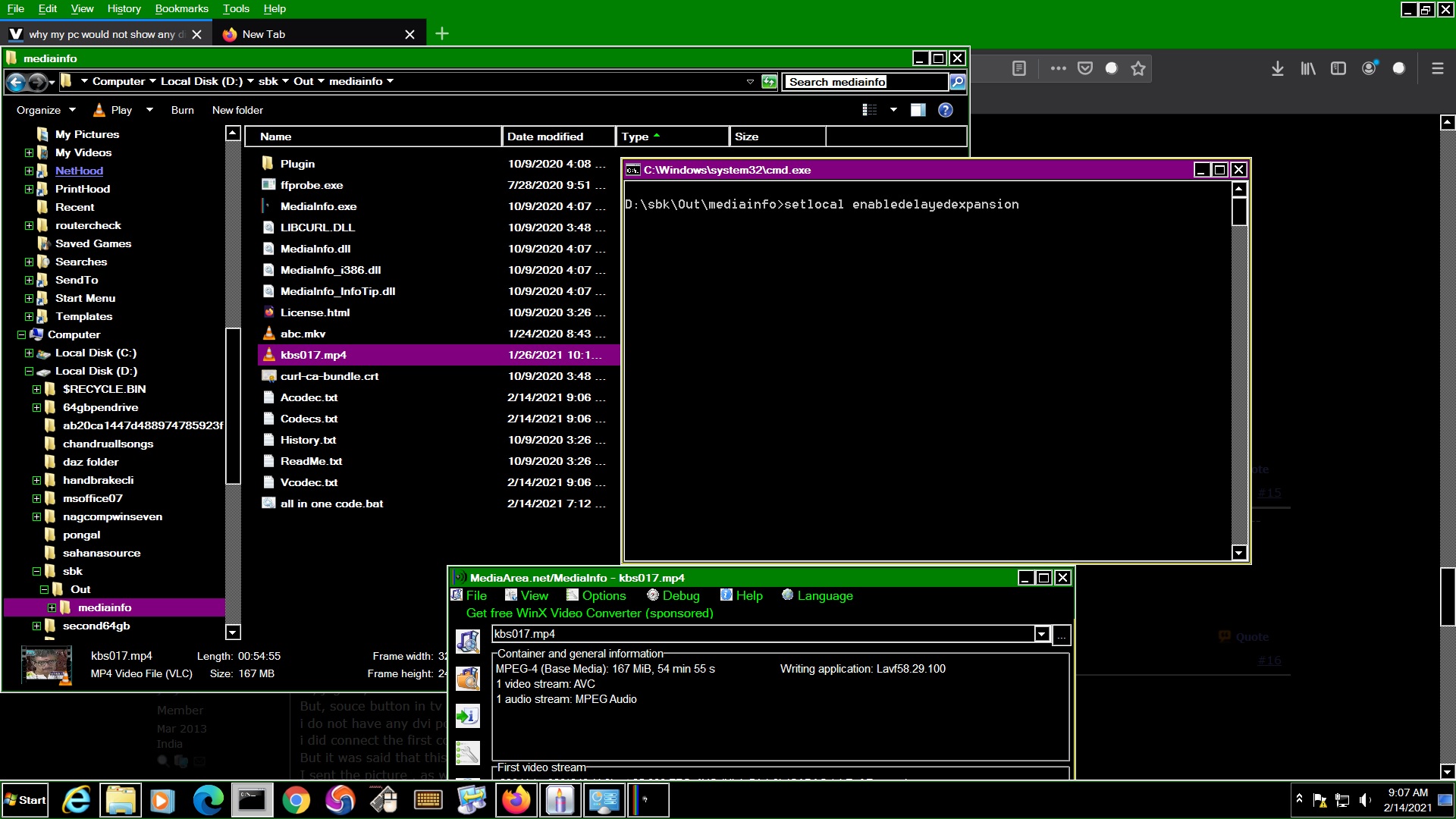

    Budman, this is news to me . I tried , it did open a command prompt and side by side opened the reference file in the media info gui.
    just it shows the details of the reference video in the gui.
    it created a codec.txt, which is as follows and it stops,
    the codec txt contains
    Reference "kbs017.mp4"
    Video= Audio=
    Is there anything missing on my part , shall I leave the gui as it is
    to proceed
