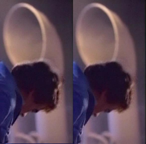

  18. The vertical blur fixes the damage caused by the non-interlaced-aware sharpen someone applied to the interlaced frames. That sharpen has created light/dark halos wherever there were combing. Fixing those halos lets SRestore() better determine which frames have blending.
    Here you can see a dark halo at the top of the guys head (it's moving down in this shot) on the left, fixed with the blur on the right:
    [Attachment 57222 - Click to enlarge]

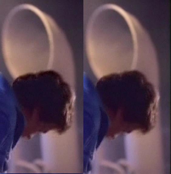

    In the next field there's a bright halo just above his head, fixed on the right:
    [Attachment 57223 - Click to enlarge]
    You can see there's still a little bit of the bright blur there. A higher blur value may be needed. About 0.4 or more.

    Thank you, jagabo, although I don't see a dark halo or outline in the first image.

    Look at the top (top as viewed in the image, not as in the top of his head is his hair and the bottom of his head is his chin) of the guy's hair. It's darker than the rest of his hair.

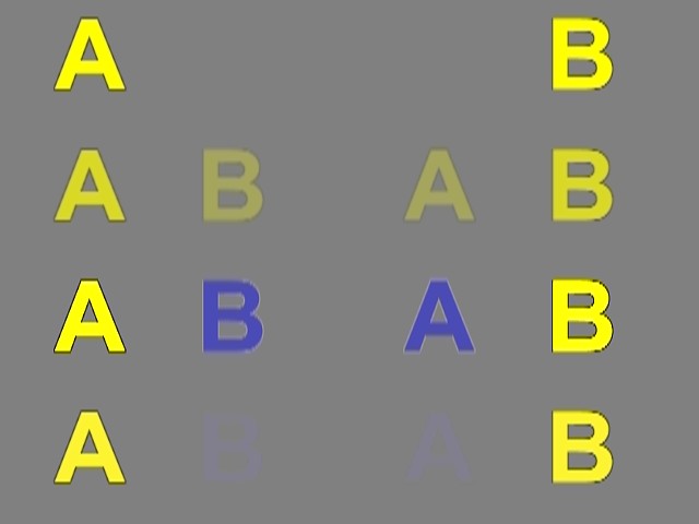

  22. Note that sharpening interlaced video produces a negative ghost of the other field. Ie, each field of the frame has a negative ghost of the other field. That's the opposite of blurring an interlaced frame where you get a positive ghost of the other field.

  24. Originally Posted by spiritgumm View Post
    Since the video was encoded progressive, I'm not sure which video you're talking about. Do you mean the original dvd video, or the script filter "Sharpen" even when it has a negative value?
    The original m2v video in your first post -- "pal dvd.m2v". The progressive encoding has caused the chroma of the two fields to be blurred together. It's hard to see in the clip because it's blurry, there's not much motion, and not very intense colors.
    Either way, I'm not sure what the implications are of +/- ghosts.
    # build an interlaced video with the letter "A" on the left in one field, "B" on the right in the other field:
    v1 = BlankClip(width=320, height=120, color=$808080).Subtitle("A", size=100, x=50, halo_color=$404040)
    v2 = BlankClip(width=320, height=120, color=$808080).Subtitle("B", size=100, x=180, halo_color=$404040)
    Interleave(v1,v2)
    AssumeTFF()
    SeparateFields()
    SelectEvery(4,0,3)
    Weave()
    ConvertToYV12(interlaced=true)
    # show what happens when you blur/sharpen interlaced video without an interlace aware filter
    StackVertical(Bob(), Blur(0.5).Bob(), Sharpen(0.5).Bob(), Sharpen(0.5).Blur(0.40).Bob())
    # stack the two fields side by side for easy analysis
    StackHorizontal(SelectEven(), SelectOdd())
    [Attachment 57228 - Click to enlarge]
    The top pair is the interlaced frame deinterlaced with a simple Bob() with one field on the left, the other in the right. You can see that one field contains the letter A, the other the letter B.
    The second pair shows what happens when the video is blurred while interlaced. Notice the positive ghost of the other field's letter.
    The third pair shows what happen when the video is sharpened while interlaced. Notice the negative ghosts of the other field's letter.
    The last pair shows the result of blurring after sharpening created the negative ghosts. The ghosts are almost completely gone.
