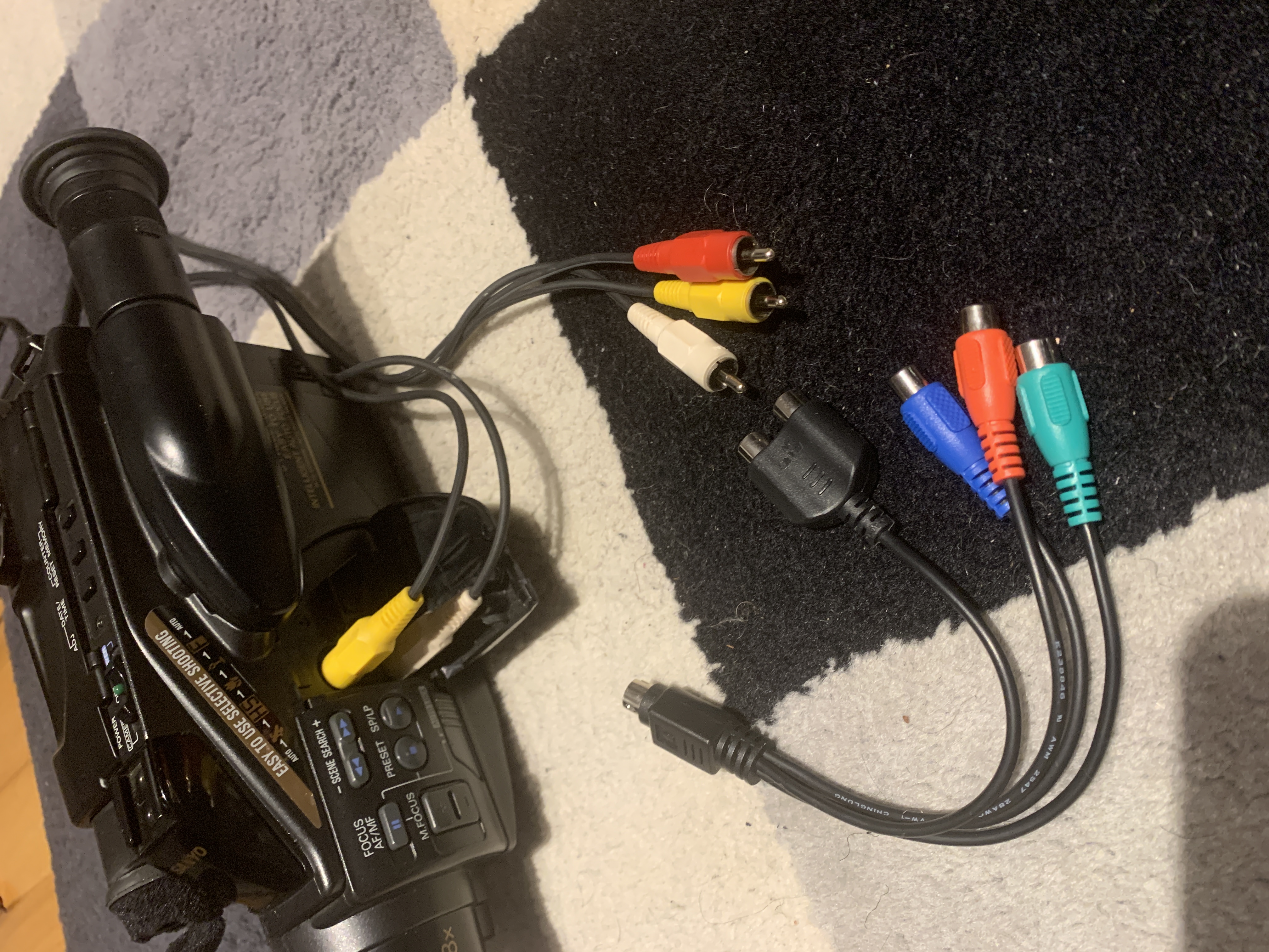

    I am recording tapes from my Hi8 camcorder, into my Elgato Game Capture HD, into my PC. The camera has two A/V outputs, yellow and white. I have a cable running from these into a component/S-Video converter so that I can connect the camera to the capture card. The video output is in black and white. Is there a certain adapter I need? I'm asking because I used my MiniDV camera with the same setup and the output was in colour. Thanks.

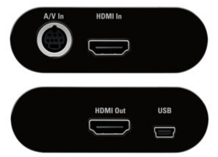

    The capture card only has S-Video and HDMI inputs. I only have an S-Video to component adapter at the moment.

    No, the capture card can only captures component (Red, Green, Blue) and HDMI, You got the wrong capture device buddy. You should have asked before clicking "Checkout" button. Now I see that the cable breakout is made for this special application, it is not S-Video.

  8. The plug which looks like a S-Video connector is another Mini-DIN connector with more contacts probably made for custom usage, in this case for the Elgato Game Capture HD. But it is NOT an S Video connector. Just count the pins.

  9. Yellow to red of the red, green and blue plugs -> composite video, but set the software to composite
    the red to the red of red and white and the white to the white of the red and white -> stereo audio for left and right channel
    For S-Video, you need a special adapter cable from Elgato.

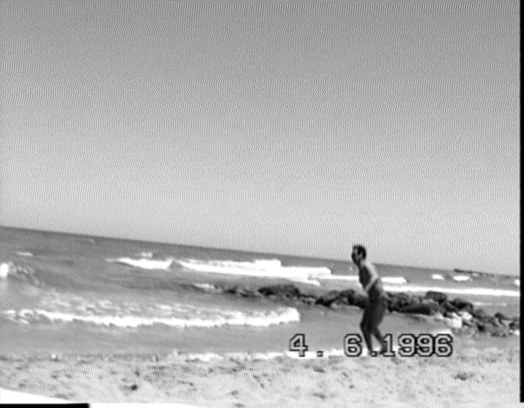

    I'm using the Game Capture HD software for the capture card. Software has an option for S-Video in as well, so it must support it somehow. Also, how come you think the camcorder is fine? Every output I have tested, including the viewfinder, is in B&W.

    Running composite video into the luma pin of an s-video device will result in very noisy video as the chroma carrier won't be removed from the luma:

    That makes sense, the video is quite noisy actually. Is there a workaround for this?

  24. Yes, that looks like the capture device is expecting s-video but getting composite on the luma pin. The fact that the noise is there indicates there is color in the composite signal. Just go to the capture software/device settings and set to composite, not s-video.
