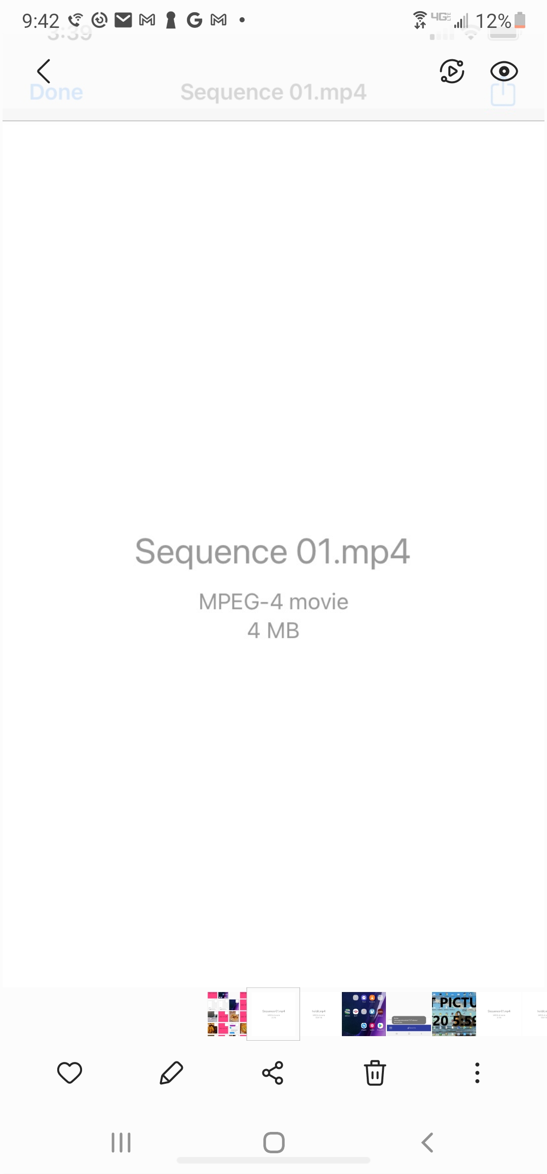

  1. For some more clairification. Here is a video I tried to send someone in a text message. I'd do that if it would work so he could view the video. It was originally taken on another device, which was an Olympus digital camera that was mainly for taking stills but could take short videos as well. I tried to send it in a text and here is what happens when I try to send it to him in a text message, failedprocess.jpg If you need the video itself, I could send that to you/post it here if possible.
    Is there a way I can convert it to 16:9 with Adobe Premiere Pro CS6?
    The above video with that error message he WAS able to play when I sent it to him in an email on his phone, but NOT a segment of an MP4 I sent to him via email. I saved the segment as an MP4. He gets this message when it he tries to open it on his phone. Maybe do you need the player he is trying to use?
    The first error message hold it, I tried to email to him thought it was a little too big to send in an email- that THAT is why he couldn't open it. So I took an even shorter clip of the MP4, which had problem sending but he is still not able to open it. I can provide you with those clips as well, if you need them................I just have to find out how I can move screenshots from a text into my android gallery.........so that I can send them to my PC with feem.......did a google, don't want to use a third party tool if I can avoid it.

    And..........here is the error messages (may not be enough info, I'll still have to see what happens on his phone) when he tries to view the video, that he gets
    [Attachment 57247 - Click to enlarge]

    That's not the video he can't watch, it's Sequence 01.mp4 he can't watch, which was never on facebook........unless you are saying I can somehow convert it to the format the videos that were on facebook are, (the ones with kano in the filenames)
  23. Guess nobody really knows. It's probably unrelated, but I did want to start a video project, just kinda want to know why this doesn't work unless I run into it again. It must have some answer.

    What the problem is with the Sequence01 file, why the person I am sending it to on his Iphone can't view/play the video.......and what can be done, if anything to fix it.
  26. Member
    Mar 2008
    Has your file recipient tried installing VLC on their device to see if it will then play?
