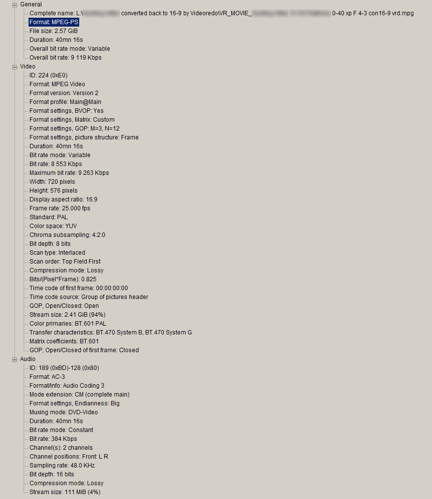

    I attach the mediainfo of a .mpg video.
    I would be more comfortable placing into TMPGencAW files that are good to go and show me how many I can fit in , then make the menu, and simulate then output, than make a menu of something I dont know is going to be ok.
    DBenz

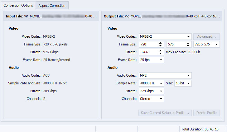

    I have AVS Video Converter 9.1
    so do I simply browse to the .mpg 2Gb video file that was produced by VideoReDo after I removed the unwanted parts, and select for output the button 'to mpeg'
    For my first video for which I have posted here the mediainfo data, (40mins 2.57Gb) it gives me the attached output options.
    Are they ok ? I see no codec x265 mentioned but its other options dont have this in the drop-downs, the only other video codec is mpeg1
    It has chosen a smaller bitrate.
    4kblurayguru...encode at 4,500 Mbps VBR
    so I need to up that to 4500 from 3766, the original being 9263, would that be so ?

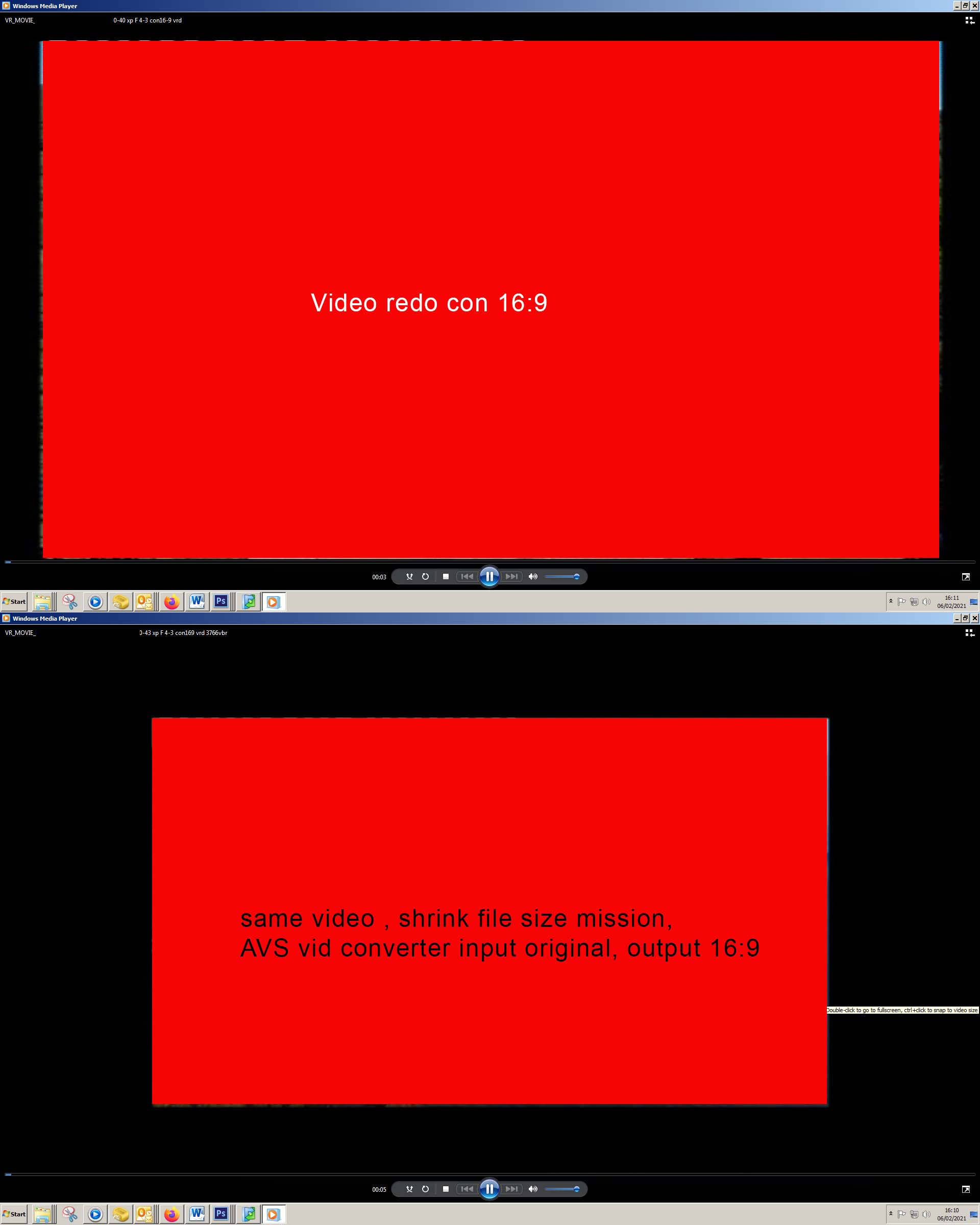

    I see by the way , the original footage was HD 16:9, when it gets to PC via dvd_ram from the panasonic DMR BWT850 its as SD but ratio is 4:3 720x576, videoredo I used to alter back to 16:9 . Will AVS need telling to keep to 16:9 ?
    Its first output on 4500 ended up playing 4:3
    I did a second choosing 16:9 from its second tab, but it plays with black margins and doesnt fit PC screen in win media player, its shrunk w and L.
    I choose the original that was created by VideoRedo which is 720x576 4:3 and choose ijn the aspect tab input original, output 16:9 and 4500vbr, result is showing as 4:3 in mediainfo and again doesnt play full width, yet the remuxed in videoredo to 16:9 does fill screen.
    Why when choosing 16:9 does dvdshrink not make it 16:9 same as videoredo does ? I certainly need it as 16:9 else its distorted, circles as elipses etc. I see no settings to do this except in the output aspect tab and I am choosing 16:9 !
    What I do see is it taking the 4:3 shape (which is distorted and circles are elipses pointing up/down, ) which is shown in its 4:3 shaped preview screen as fully to top/bott and full width and when I select output 16:9 it adds in grey margins top and bott but the 4:3 shape remains the same and the circles remain as elipses (circles with sides compressed so main axis is north/south ), so unlike videoredo who make it 16:9 and it plays 16:9 filling my PC monitor, it is keeping what it believes is the correct shape of everything in the video, but it isnt. the footage was 16:9 shape with normal circles.
    Remember the original was that 16:9 ratio and HD but copying to the Panasonic only allows SD, but when then played from the Panny to the TV they are 16:9, and normally also as such on the PC after transfer with dvd_ram disc. For some reason some are coming from dvd_ram as 4:3 720x576 and others 16:9 720x576.

    Anyhow, I take two videos given 3766vbr and drop them into TMPGenc and that 4.7Gb bar is filled up same amount as if I had used the two original files, so nothing gained at all.
    DBenz
Name:	AVS video converter 9.1 in and out options default.jpg

    the old one 2004 is the only one I have installed, and it wont recognise the .mpg file
    I have used AVC Vid converter as was suggested and the bitrate that appeared by default, and still as mentioned the two videos fill up the 4.7Gb, yet bitrate was apprx 1/3 of the original. 3766 versus original 9263
    also AVC as mentioned is keeping video 4:3 shape even when choosing 16:9, yet Videoredo manage to remux at 16:9 and it plays fine in windows media player or jaksta.
    see attached.
    DBenz
Name:	AVS 43 v 169 on 720x576 169 after VRD 43.jpg
Name:	VideoRedo con 169 played in WMP and compare AVS con 169.jpg
