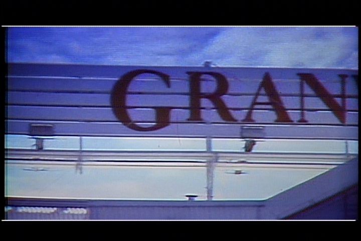

  9. "They didn't cause the interlaced blended chroma issues..". Unfortunately they do. Take a look on chroma shift around letters https://files.videohelp.com/u/298329/restore.jpg. So, what would be the case of such tearing?
  10. Originally Posted by semel1 View Post
    Yes, there are problems in the source. It's unclear if your original precapture source has that, or if there were some issues with the capture process . Provide more information on the original source pre-capture. Did they have the tearing to begin with? Is it nth generation, etc...what is it the background info ?
    The point is there were additional problems with chroma blending on top of that when resizing the chroma progressively, when it was still interlaced, in the MP4. A studio would not introduce those additional problems. Interlaced 422 chroma was converted =>420 chroma progressively instead of in an interlace aware fashion, or removing pulldown before resizing progressively. The MOV does not have those additional issues
    Use jagabo's script on the MOV
    [Attachment 57127 - Click to enlarge]
    On the MP4
    [Attachment 57128 - Click to enlarge]
    Do you see the difference?
  11. Yes, the hotel_10bit.mov file didn't have the blended chroma. That was caused in the earlier sample by encoding interlaced video as if it was progressive. The script I gave earlier works with the mov file and delivers a result with relatively free of blending. If you want to get rid of some residual comb-like artifacts follow the earlier script with:

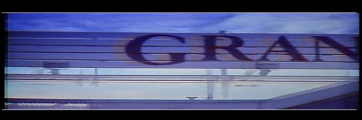

  12. Another way to look at it , I crop 6 off the bottom and separated the fields
    Crop(0,0,0,-6,true)
    SeparateFields()
    MP4
    [Attachment 57129 - Click to enlarge]
    MOV
    [Attachment 57130 - Click to enlarge]
    That's what you're starting with. The additional problem is introduced by the 422=>420 progressive downconversion while still interlaced
