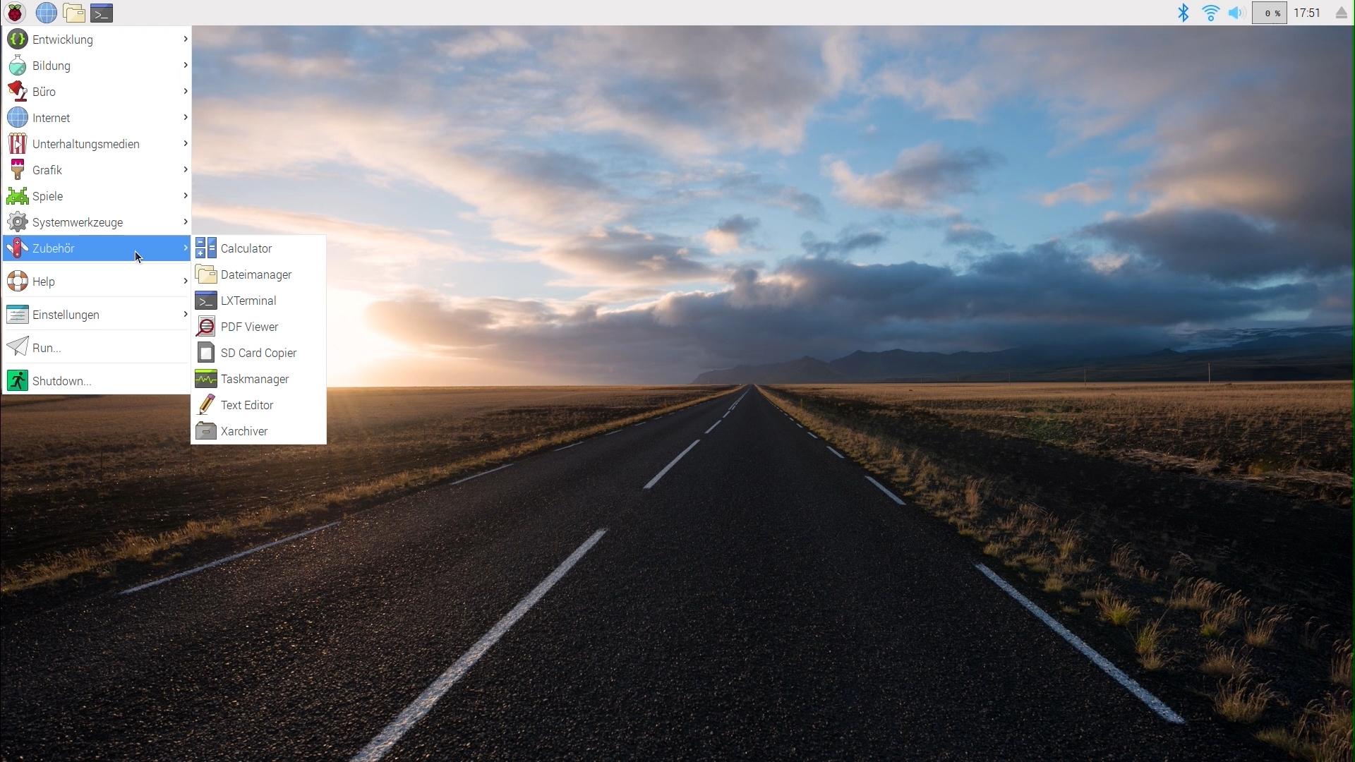

I don't know how your video got this way but if you rotate it 90 degrees, swap pairs of scan lines, then rotate it back to normal the video is fixed. In AviSynth:
Code:LWLibavVideoSource("0118_H17M51_HDMI.mkv", cache=false, prefer_hw=2) ConvertToYV24(interlaced=true) src = last AddBorders(1,0,1,0) TurnRight() SwapFields() TurnLeft() Crop(1,0,-1,0) MergeChroma(last, src)
[Attachment 57089 - Click to enlarge]
Swapped fields like that aren't unusual with some video capture devices. Are you running a monitor in portrait mode? Are you using an MJPEG codec anywhere?Last edited by jagabo; 31st Jan 2021 at 18:53.
