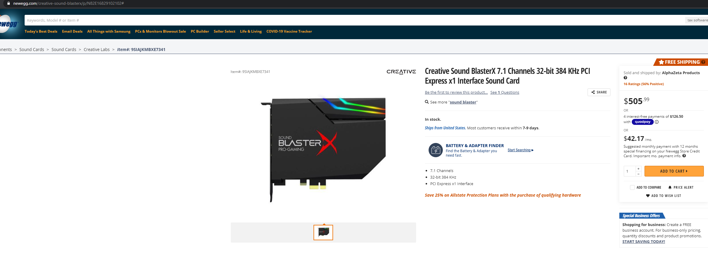

  11. Member Cornucopia's Avatar
    Originally Posted by Videogamer555 View Post
    Ok, so what about those 384khz cards in that list make them not acceptable?
    CL SoundBlasterXL might be consumer & gaming centric, but it's legit 384 capable.
    And RME is well known as one of the leaders of 384 capable DAWs.
    You could tell us what you are trying to capture without being so vague, and we might be able to point you to something more appropriate...
    Also, have you considered the inherent bandwidth restrictions in the analog side of your chain? Would be a shame to get something so deluxe and not be able to legitamately pipe what you want into it.
    Sound Blaster XL doesn't even exist. I just checked that specific item in google search.
    Had a typo, was supposed to be X instead of XL (saw the 1 and thought it was an L), but regardless...did you click on the links? It's right there...

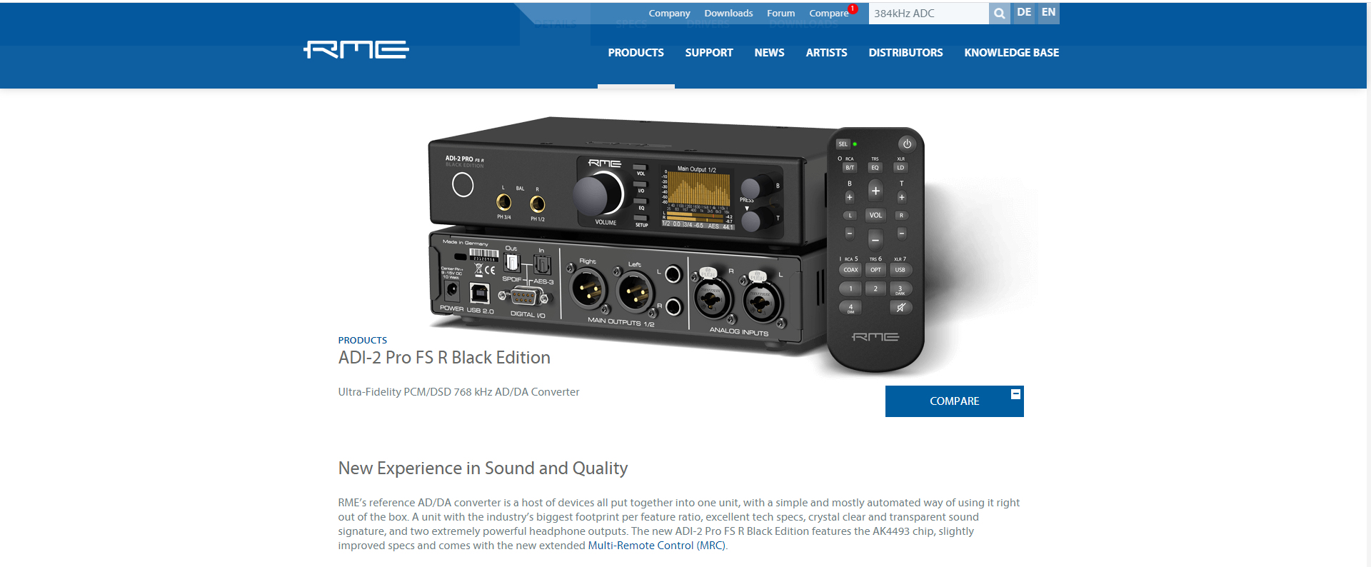

  13. Member Cornucopia's Avatar
    Whoops, you're right @dellsam34, those are only 384 in the DAC section.
    OK, how about this?...
    RME, purports to support 768 in and out, as well as DSD sampling.
    [Attachment 57136 - Click to enlarge]
    I knew RME would have something like that (used to work on RME/Pyramix board in sound design 15 years ago).
  14. Originally Posted by Cornucopia View Post
    Just googled it. It costs about $2000. I can get a USB-connected oscilloscope cheaper than that with a 100MSPS sample rate. I was interested in a super high sample rate sound card for 2 reasons.
    1: I assumed professional audio equipment was cheaper than scientific equipment.
    2: I wanted the convenience of using normal audio software to capture the signal, instead of depending on proprietary software written by the hardware's makers.
    I already have Goldwave audio software which supports sample rates up to 500kSPS, which is more than enough for the particular experiment I'm doing. A soundcard with a 384kSPS sample rate would actually be sufficient for what I want, as it would give me a full 192kHz bandwidth. I actually only need about a 150kHz bandwidth (300kSPS) but it's unlikely too find such a sound card, as sound cards seem to be power-of-2 multiples of 48kSPS (48, 96, 192, or 384 kSPS). So that's why I made my request for a 384kSPS sound card.
