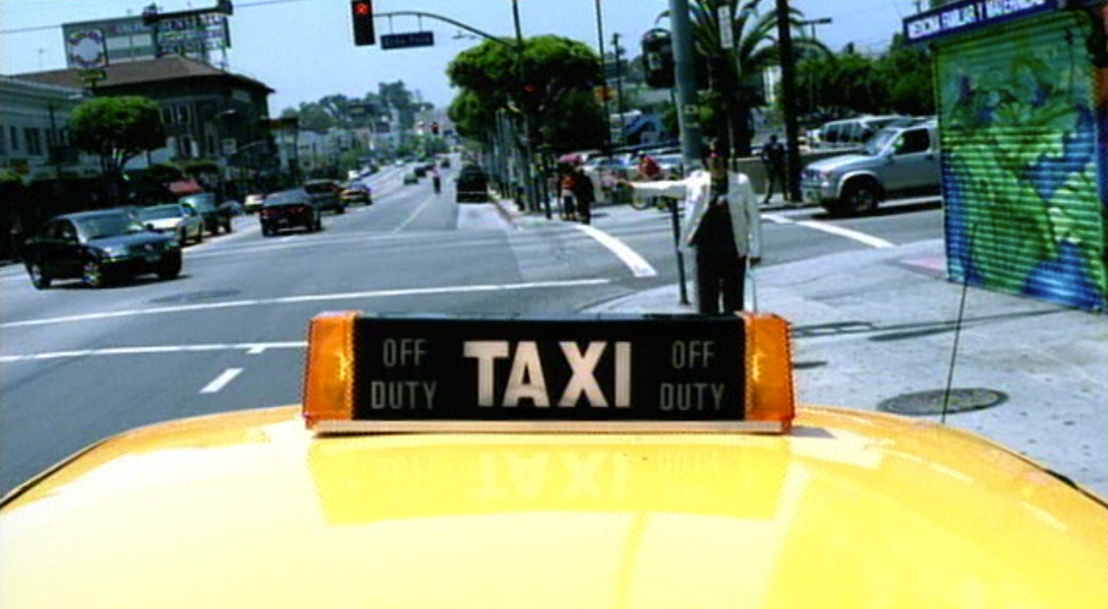

    I was trying to remaster/restore RHCPs "By the way" music video however i stumbled upon this stupid dot crawl. Is there any way I can remove it?
    note: its even more visible in some scenes, and video file i have is in .VOD format
  2. AviSynth has lots of dot crawl and rainbow filters. But you'll have to supply a sample of your original MPEG 2 data to see what works best.

  4. You need to supply a sample that has not been reencoded. I believe you can use Mpeg2Cut2 to trim out a short sample from your VOD file. Upload the resulting MPG file to this site.
