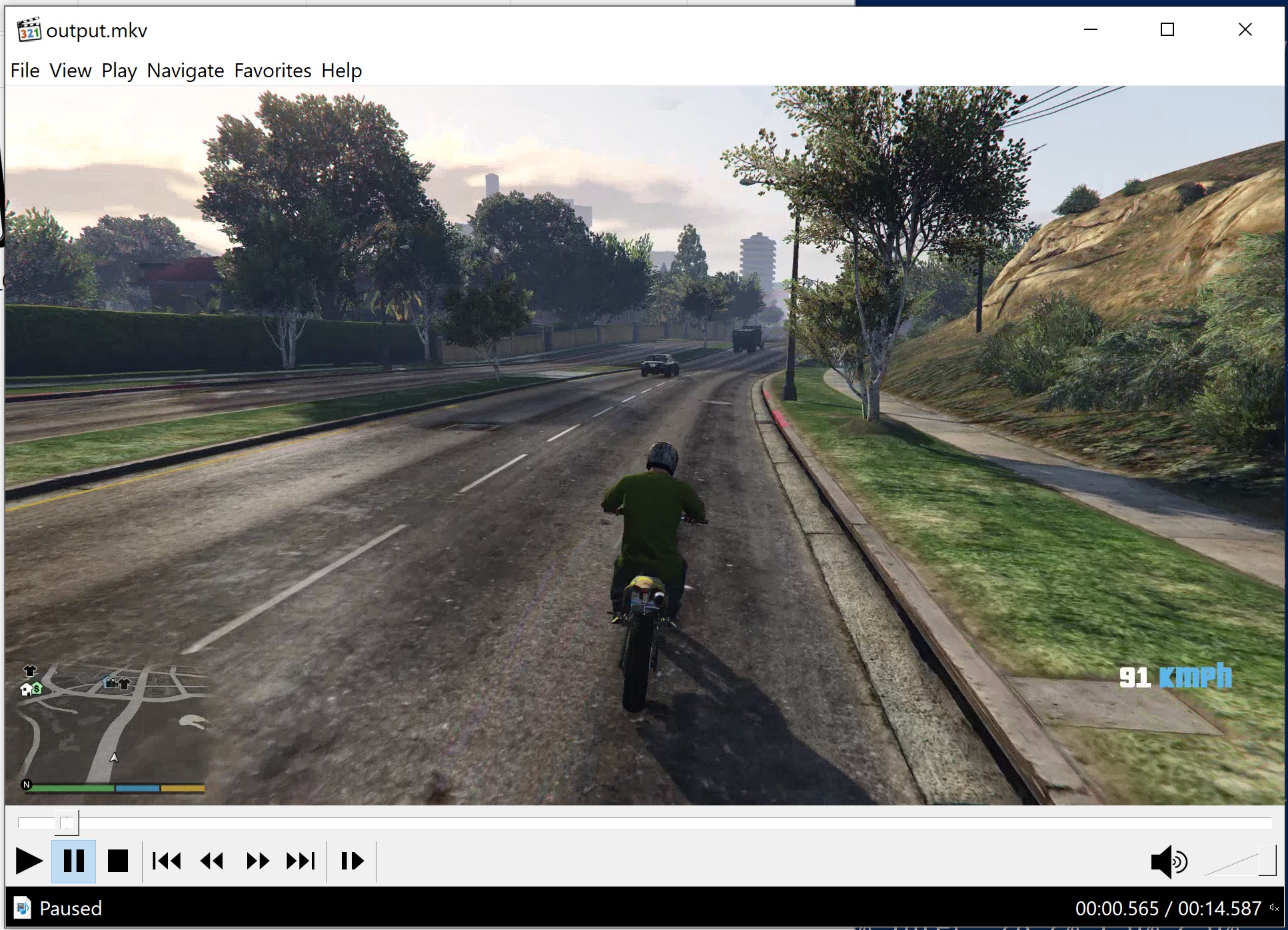

    ffmpeg -i FastMotorcycle_02_30fps.mkv -r 240 -filter:v "setpts=0.125*PTS" -preset ultrafast output.mkv
    The above output results in this uncorrupted video:
    [Attachment 57051 - Click to enlarge]
    It is actually a working 240fps output video.

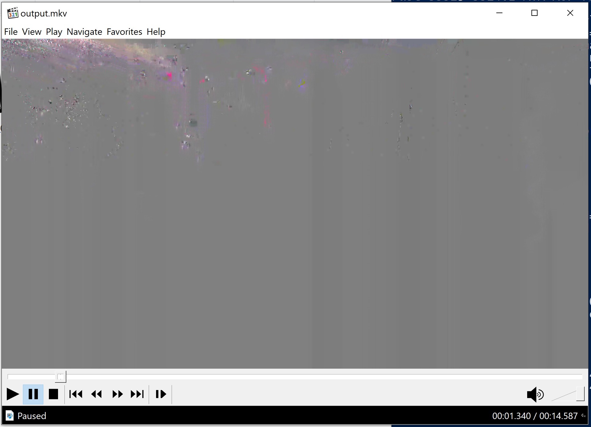

    The problem is, only this past week or so I've only been able to get good output videos from using the faster end of the "-preset" parameter, as opposed to "-preset veryslow" that I used previously that I prefer. The following command, which is only different from the one above in that it doesn't use a "-preset" (and I've tested and received similar results with "-preset veryslow"):
    ffmpeg -i FastMotorcycle_02_30fps.mkv -r 240 -filter:v "setpts=0.125*PTS" output.mkv
    The above output results in this corrupted video:
    [Attachment 57053 - Click to enlarge]
    I'd like to figure out what is causing this issue to hopefully solve it and get back to higher quality encoding, and maybe learn a bit about FFMPEG along the way. If you need any more information or more specific details, just let me know and I will provide them the best I can.

    Hi ProWo! Thank you for responding, I copied and pasted the command directly into PowerShell (after making sure my input video was named "input"), and it yielded a similar grey corrupted mess of a video. The input video plays perfectly at 30fps.
    Would it be a good idea to upload the input and/or output file to my google drive so you or someone else can take a look at it? Are there any logs or anything I could post that would be helpful?
    I forgot to mention, this issue only seems to happen with videos recorded using NVENC (NVidia GPU encoding), videos encoded with the CPU do not seem to corrupt like this. Thanks in advance to anyone who replies!

  4. Originally Posted by 31feesh View Post
    Yes, both.
    You may have a playback problem (ie, computer can't decode the video fast enough, medium preset is much harder to play than ultrafast), not an encoding problem. Another possibility is that the decoding of the source video gets screwed up when the more complex encoding requests frames out-of-order.

  6. Are you sure the "download" links lead to re-encoded videos? The output video has x264 metadata that matches an encoding with the medium preset (the default). And it plays with no corruption here. Even if google did convert it the result would have shown corruption if the video you uploaded had problems.
    Try turning off hardware decoding in your media player. Or, if it's already off, turn it on. See if there's any difference.
    In any case, many computers can't play 240 fps 1080p videos properly. So there's it's not really surprising you are having problems.

    So I checked the video that the download links to and found that it was just a preview video that I was seeing on Google drive, and it did not actually reencode it.
    But thanks for the suggestion to turn off hardware decoding, I didn't think much about the video player side of things! I tried it with VLC media player and it's playing uncorrupted now, if slower.
    With that said, I still don't get what I was doing differently a month ago to have it working then but not now. Oh well.
