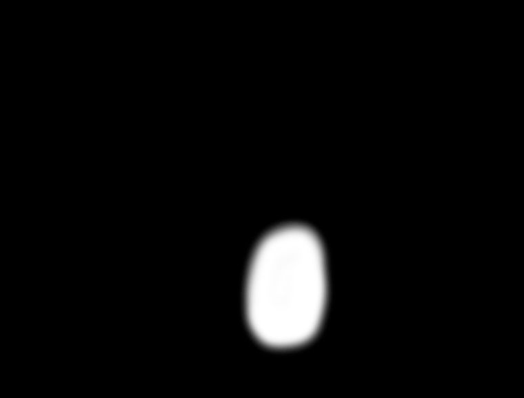

Mask:Code:video1 =FFvideoSource() video2 =FFvideoSource() # MASK1=CoronaSequence(file="C:\code\01.png").ConvertToYV12(matrix="pc.601") MASK2=CoronaSequence(file="C:\code\02.png").ConvertToYV12(matrix="pc.601") # CLIP_MASK1=Overlay(video2, video1, mask=MASK1).Subtitle("merge+mask > test") CLIP_MASK2=Overlay(video2, video1, mask=MASK2).Subtitle("merge+mask > test") # R1=ReplaceFramesSimple(video2, CLIP_MASK1, mappings="[9565 9627]") R2=ReplaceFramesSimple(R1, CLIP_MASK2, mappings="[10588 10604]") return R2
[Attachment 57038 - Click to enlarge]
In this test, the mask goes from 9565 to 9627, but the scene moves, I would like to know if there is any way to move the white part to avoid making multiple duplicates of the filters, as I already have many lines of them, aside from the fact that it would make the process easier, as I have other masquerade models to add.
Thank you in advance for any ideas.

I you mean you need to have the mask track some moving object, that object doesn't change size/shape, and te movement is linear, you can easily use Animate() along with Overlay() to move your white blob.Code:video1 =FFvideoSource() video2 =FFvideoSource() return(StackHorizontal(video1, video2))
Yes, I need to make this white area go from top to bottom in a straight line, it does not increase. I had looked at Animate yesterday, but I couldn't fit it into this script.

I don't know exactly what your requirements are but here's an example of moving your mask over frames 100 to 199:
Code:function MoveBlob(clip c, int xpos, int ypos) { BlankClip(c, color=$000000) Overlay(last, c, x=xpos, y=ypos) } video1 = BlankClip(width=720, height=576, color=$ff0000) # a red video, just so we can see the results video2 = BlankClip(width=720, height=576, color=$00ff00) # a green video, just so we can see the results blob = ImageSource("blob.png").BilinearResize(video1.width, video1.height) blob = Animate(100,199, "MoveBlob", blob,0,-300, blob,0,50) # move the blob over frames 100 to 199 Overlay(video1, video2, mask=blob) -
Thanks for the help, Jagabo.
I was able to do it by your method and I also got another one even more practical using blackness() and motion with Mocha pro.
