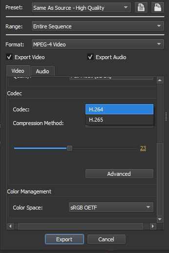

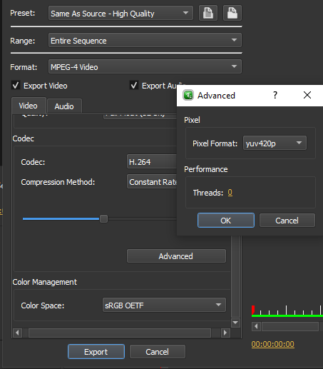

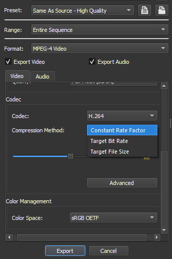

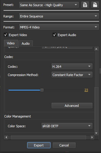

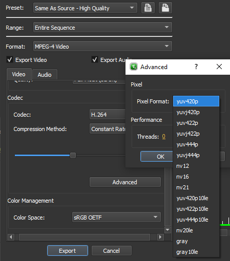

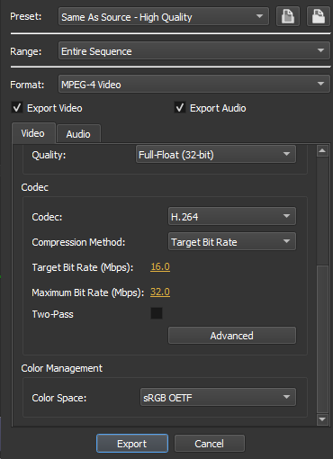

Thank you for your reply. Like you said, I checked encoding options section on Olive video editor I found those options like in screenshots, what I can do like changes ? And of course, I will let the codec in H.264 like the original video.

In your screenshot, where it says "constant rate factor" 23 , set it to some lower value like 15 to 18 . Lower values result in higher bitrates, less quality loss
Lower crf, currently at 23 (ex: try 18, lossless mode is crf 0).
You can check the characteristics of the input and output videos with mediainfo. -
I already have mediainfo , the good in this software (I mean Olive software) that it detect the video characteristics and preset settings as same as original video. I tried crf at 18 the size became 12 mb, when I tried crf at 0 it became 354 mb , is that normal ?
It might be normal;
At crf 0, it should be larger than the original
Did you use the correct project settings, and export settings in terms of dimensions, frame rate ? -

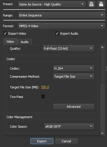

Rather than experiment with crf, why not experiment with target file size ? All other things being equal, a slightly higher than the original might suffice.
Well, I don't know if it will be effective, but I think crf method will do it automatically than do it manually like in screenshots (When I tried with different video it display the same target file: 700 mb).
It is OK for me to stay at crf 0, if it won't lose the quality.
What matters to me is that the edited video has the same quality like the original one without losing even a very small amount that I can't see.
