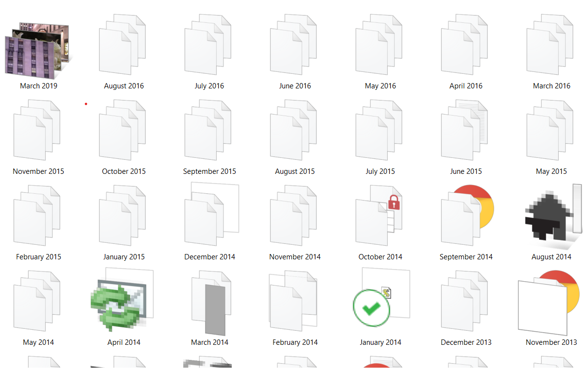

    Jan 2021
    New York
    [Attachment 57028 - Click to enlarge]
    [Attachment 57029 - Click to enlarge]
    I want the names to become the dates essentially, instead of the dates that were given to the files based on the day I transferred them. I want to have them sorted correctly in the library, instead of all ending up in a folder for 20 years later than the actual date

    Couple of quick questions... names to become the dates... grammatically means you want to change the names... names to become(changed to). I believe you want the opposite where the dates are changed to the name. Correct? Also are those supposed to be folders named July 20xx and may 20xx, etc? My windows 2007 does not display libraries or folders in this manner. ??
    Jan 2021
    New York
    I guess you are right with the grammar. I just want the videos to be dated properly so they can be sorted and viewed correctly (and the dates we need are right there in the file name)
    and as for the library folders, I'm using windows 10, with the library optimized for images, and then within the library, right click>arrange by>month

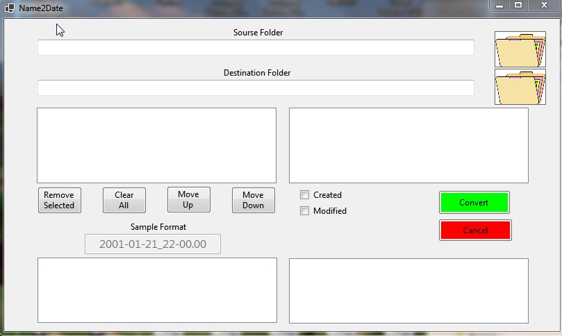

    I have a preliminary gui to do what you need but will take a couple days to finish and debug. How long can you wait? And yo be sure you want the date time in the filename to be transferred to the modified date in windows correct? I have seen this request before because of windows penchant to change when just copied transferred.
    So Far:
    [Attachment 57052 - Click to enlarge]

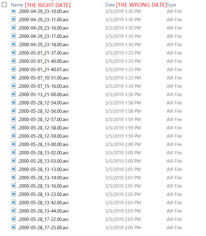

    the file names have the proper date the video was actually taken, windows does not (as its only got whatever WinDV gave it when I transferred them off the tapes, which is decades off).
    I would like either the date modified or date created (or both) to be changed to the date in the file name, which ever one windows uses when sorting libraries.

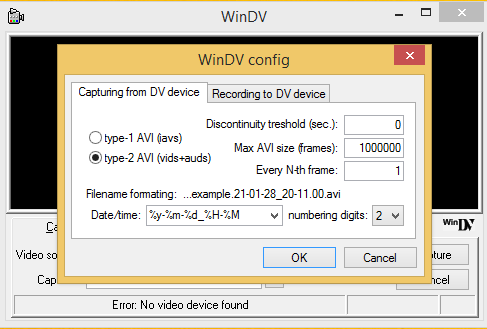

    wait. now you're saying it's a winDV problem? winDV assigns filenames only from the date/time taken on the tape in whatever format you choose.

    so to sum up what we've got so far:
    file name: correct date.
    file metadata date: wrong date.
    now what I want to do, is have the metadata date switched to the date in the name. so this way the files can be essentially archived according to date. instead of 500 videos from 2004 showing as being taken in 2019.
    because they all follow the same naming scheme, I figured it should be possible using a script or some GUI. am I being clear enough? any questions?

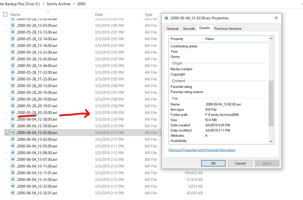

    Jan 2021
    New York
    [Attachment 57050 - Click to enlarge]
    Am I not explaining it correctly?

    WinDV didn't get anything wrong. The app named the file according to the embedded metadata (record date) in the dv streams. But the app does not change the date of the file - the OS does (for the vast majority of apps it works this way).
    And the OS is showing the modified date = creation date = date that the file was actually created.
    You might like to THINK of these as being copied, but they are not, they are captured and generated. Think of it this way: this is the first time these have ever been FILES (as opposed to streams on tapes).
    So what you seem to think of as "being wrong metadata" is correct as far as the normal processes of the OS is concerned.
    Now, there are "touch" type apps that can modify one or more of the 3 internally tracked dates (creation, modification, access), based on various criteria. That criteria COULD include the dv file's internal metadata (aka recorded date), such as what Budman1 is attempting to do for you, but this may not be necessary, as the WinDV app has already done the main work for you, so all you really need to do is bulk change the create & modify dates using a parsing of the filename.
    Nirsoft's Bulk File Change utility might be able to help, if it supports taking the date from the filename.
    It would also be quite possible to script this in Windows PowerShell, since it supports filename parsing, temp variables, and file attribute reading/writing. Heck, I could do it, but my Covid workload is such I wouldn't be able to get to it before the summer!

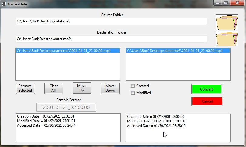

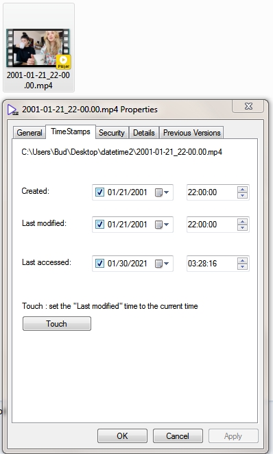

    shmuelmunkes ... So far this is what I have; Takes up to 3 wrong date characters in filename (Your example is "-" and ".") and corrects for valid file date. At the moments it always corrects both created and Modified Windows dates. Needs fix that and a few more safeguards and a couple bells and whistles. LOL
    [Attachment 57061 - Click to enlarge]
    [Attachment 57062 - Click to enlarge]

    shmuelmunkes... Give this a try. It works fine for me but I included a rar file in case it needs the other 2 files.. It shouldn't though.
    BTW Malwarebytes doesn't like it but it doesn't like a lot of Visual Studio Projects. Norton 360 is fine with it. Scan it if you wish.
    https://files.secureserver.net/0sAiMbFhnCsCvj EXE
    https://files.secureserver.net/0sFE8Vw9MycBwT RAR
    Windows Modified is pre-checked but you can pick either or both if you wish. The test button is for my testing and I never removed but it
    was a bear creating. My first form was .net 5 and json files. I tried to convert to .net 4 Framework and lost everything GRRRR Microsoft!!!
    Finally got it recreated and it uses .net 4 so shouldn't be a problem, The Source and Destination folders as well as the From folder files
    are Drag and Drop so if you want to load a folder with lots of files that do not need to be converted, click Clear and drag drop the ones you do want.
    The default example tests for your filename format but if another is entered and is valid, it will test for up to 3 non-Date/Time characters and convert them to Valid symbols for the Windows Created and Modified time format.
    IMPORTANT: ALWAYS USE COPIES OF YOUR FOLDERS TO TEST. I'm not a programmer but I never change any files but instead copy and alter the copies.
    If you try to convert to the same folder, You will get a message and allow you to correct. After conversion you can click the filename in the To folder and the
    New times will be displayed.
    Let me know if you have any problems
    Budman1
