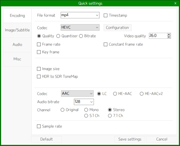

Shana Encoder does not provide detailed private option settings for HEVC(x265) unlike H264(x264).
Instead, you can put in FFmpeg option settings directly in the Parameters window by pressing F8.
For example, after selecting basic option values in Quick Settings as follows

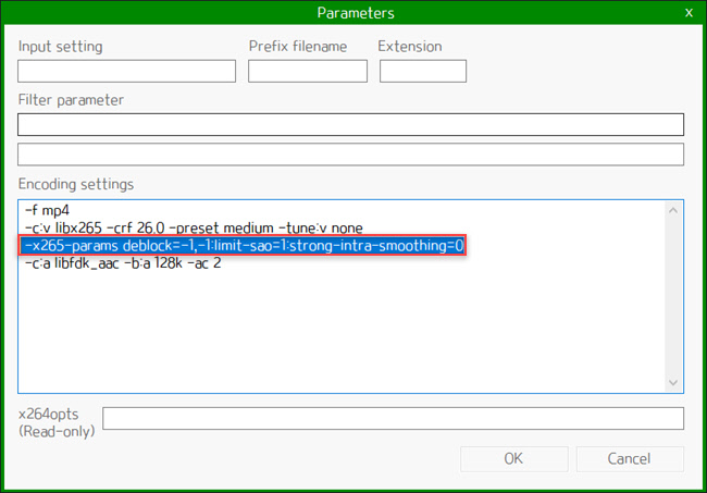

press F8 and enter these extra FFmpeg parameter settings:
Code:-x265-params deblock=-1,-1:limit-sao=1:strong-intra-smoothing=0
[Attachment 57011 - Click to enlarge]
There must be a space at the start.
You need to translate x265 options introduced in the x265 manual to proper FFmpeg parameter settings by removing the double dash prefix, replacing colon with comma, and using colon as the delimiter between parameters.
And like I said, reviewing the log is very important in case you run into an error. Press F5 and see what the log tells you.
