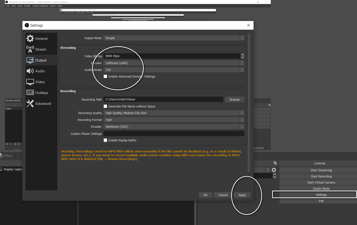

  8. You should see something like this, after clicking the settings icon.
    Don't forget to apply the changes you make in the output tab.
    [Attachment 57012 - Click to enlarge]

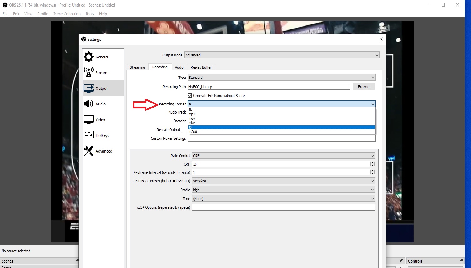

    There isn't an option to save a recording as an avi either..........
    [Attachment 57017 - Click to enlarge]

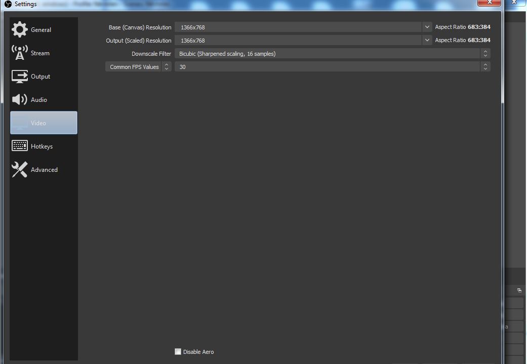

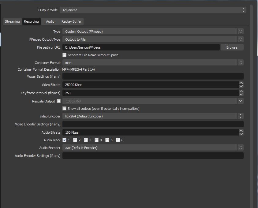

    Here are some tests and screenshots. On the images you can see my recent settings. I attached what file these settings produce. The bitrate is nowhere near the amount set. I set 25000kbps and if you check the file with mediainfo it shows it is at 1330kbps.
    The resulting video is blurry. If I install the software: ScreenRec, it produces a crytal clear video. I am just hesitating to use that software due to some notices about security issues.
