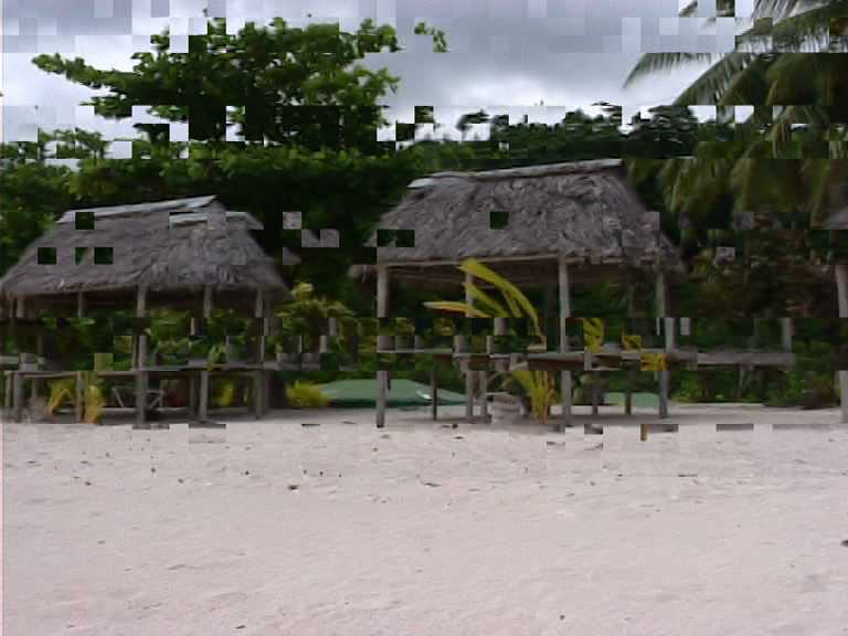

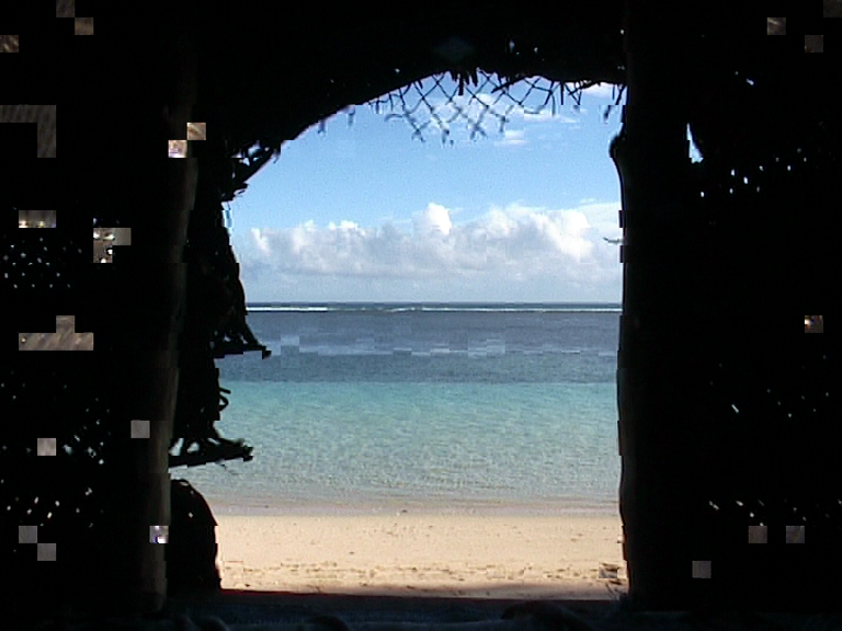

On a trip to the South Pacific in 2002 I had a DV-camcorder that had a problem with really high humidity and because of this a lot of my videos from the trip have missing pixels (see screenshoots). Any chance theres is any software that would be able to repair this? Perhaps with help of AI?
[Attachment 56933 - Click to enlarge]
[Attachment 56934 - Click to enlarge]
The video is filmed in PAL 576i.
Would be really great to finally be able to repair these. Thanks for any suggestion and help!

@johnmeyer & @Cornucopia You're right about the lost pixels come and go and in various places of the frame. See the attached.
I was kind of hoping some kind of smart AI software could look a few frames back and forward and based on that calculate/guess what should be in the missing pixels. But I do understand it's quite a challenging task and perhaps there's no software doing this.Last edited by TravelRock; 24th Jan 2021 at 08:24.

Noise is noise, and there are a whole palette of tools to work with denoising, depending on the character of the the noise. That particular noise has some definite characteristics: Certain horizontal macroblocks appear to be delayed in time compared to other macroblocks, within those macroblocks there are other blocks that are further delayed, there is very little of the image that is WITHOUT signal (it is there, just at the wrong place/time), and it is (obviously) blocky. These characteristics should guide you toward your choice of method.
