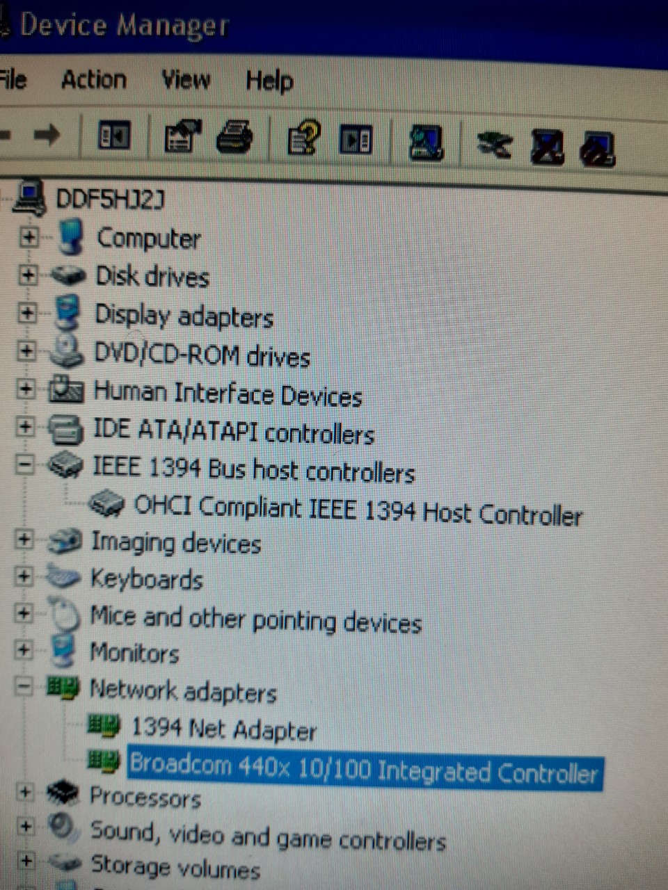

  9. Okay, no issues with IEEE 1394 Bus Host Controller - picture below.
    Not sure what you meant by selection box but a picture of the scenalyzer is below also.
    Tried the method suggested and got the same results.
    It is an add-in firewire card.
    Hope that helps

  10. Member DB83's Avatar
    Jul 2007
    Where you see 'Microsoft DV camera....', can that selection be opened to reveal other selections ?
  11. hi, no thats the only option

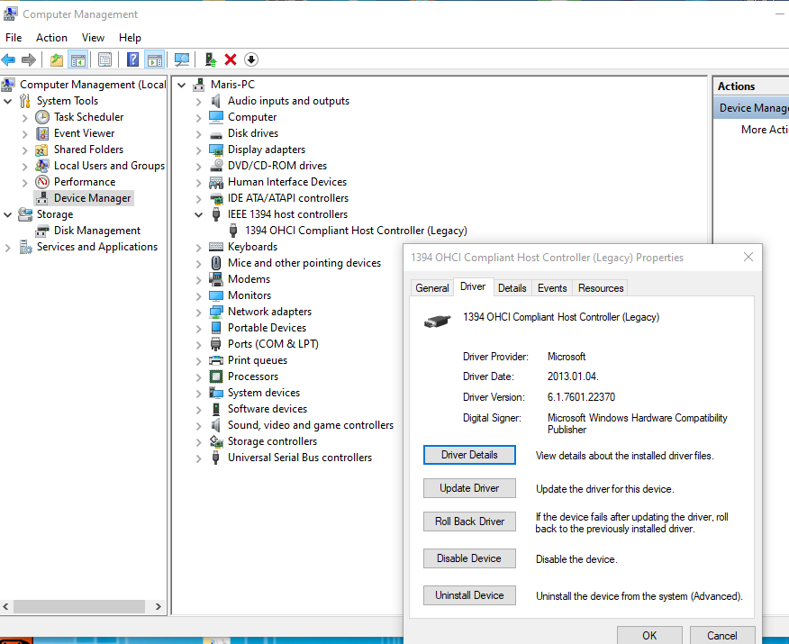

    Hi,
    My memory is not so good anymore, but as long as I remember, when switching from XP to Win 7 and later on Win 10, I had the same problem. WinDV saw my miniDV camera, but I could not capture. As I remember the problem was in the Firewire (IEEE1394) drivers, not the IEEE 1394 adapter.
    To solve the problem you need to find, download and install Legacy IEEE 1394 drivers. And Voila! everything works.
    Maybe at first uninstall the installed driver from Win 7 / Win 10 and then install Legacy driver.
    I hope this will help. Please tell the results.

    Nov 2015
    Latvia
    [Attachment 56959 - Click to enlarge]
    Here is the Print screen.
    Panasonic NV-HS860, LG LV 880 HiFi 6 Head, Sony SLV-SE 630 HiFi, LG BL-162W, Sony TRV33E miniDV for Capture, Canopus ADVC 55, Panasonic DMR-ES10, Sony Vegas Pro12, WinDV

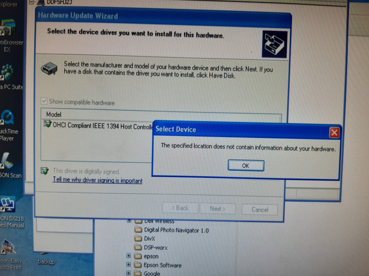

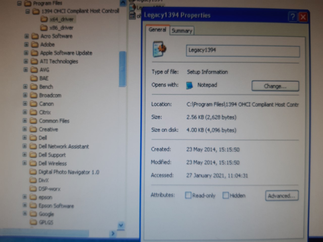

  19. so the current driver is in image 'driver as-is'
    The legacy driver I have is in 'driver to-be'......but it is way newer than the one Maris has in post #14.
    The error I get when trying to update is in 'driver-error'
    Thanks all

  20. Member DB83's Avatar
    Jul 2007
    Well the driver (1st pic) appears to be exactly the same as the one on my own XP system - see my earlier post #16
    You can not install a legacy driver for XP unless the driver worked in Win 3x. The whole point of a legacy is to support later systems where there is no current driver. So Win10 uses the Win8 driver in legacy mode.
    The final step from the current install is to click 'Driver Details' and see if there are any issues.
